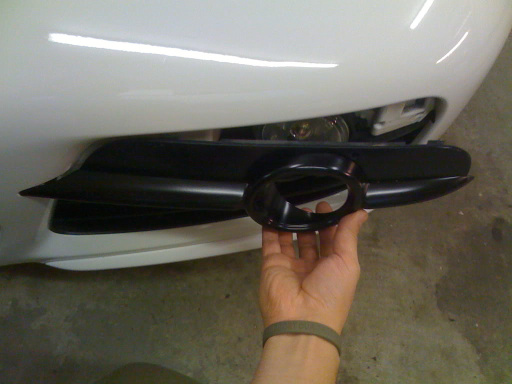

First remove your foglight shrouds, pull out at the bottom of the shroud then you will hear it snap off.

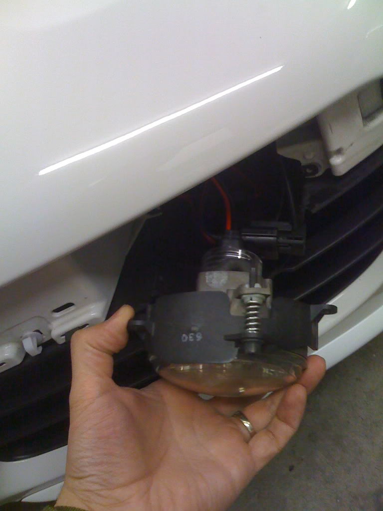

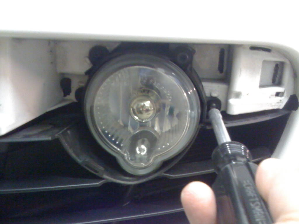

this will expose 3 phillips bolts, remove them and the housing will come out.

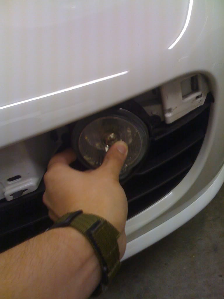

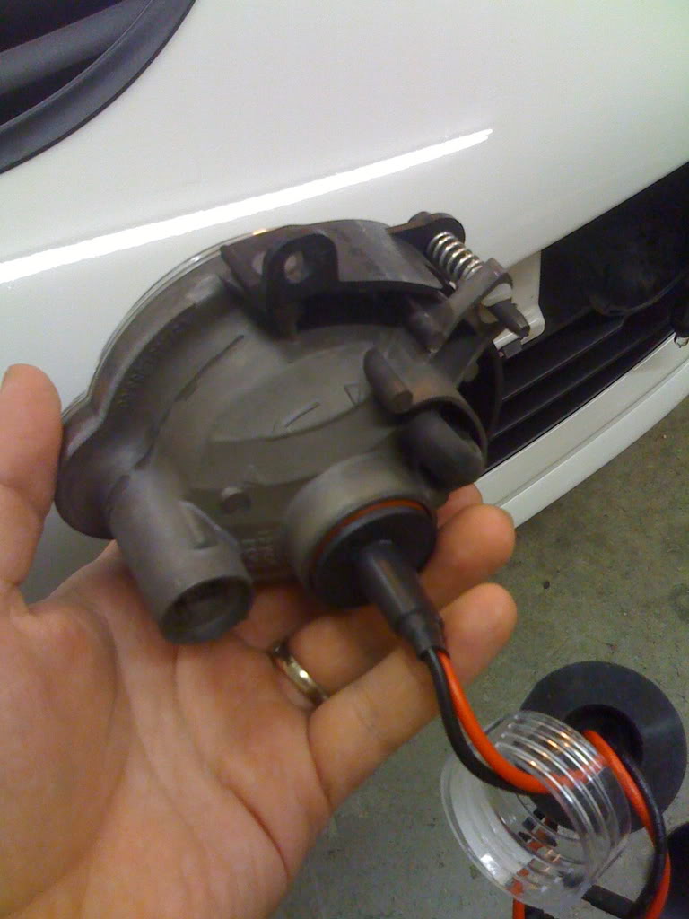

after removing the light bulb by turning it to the right, using a pick pull off the light clip covers.

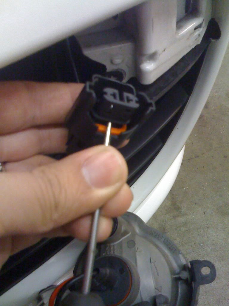

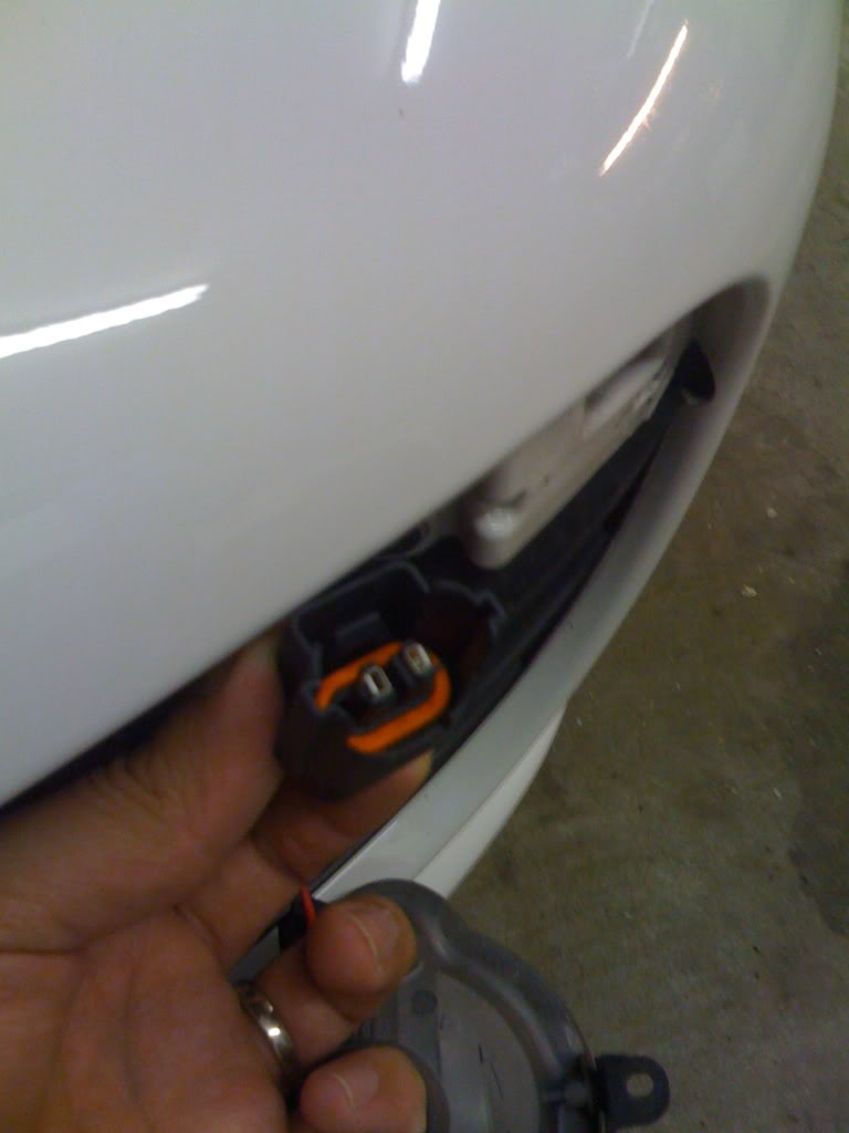

you should have the connections exposed now.

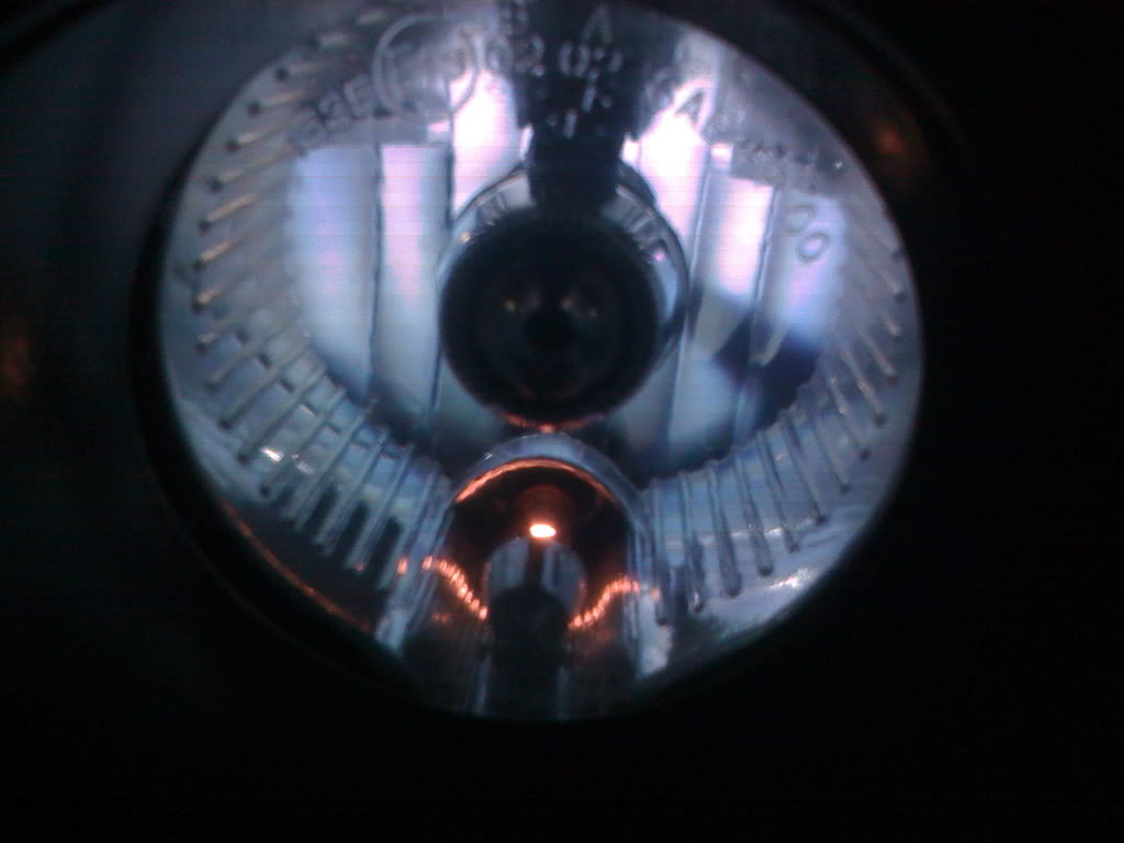

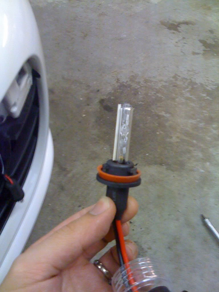

take the bulbs out of the special clear cases and install them into the housing. One of the bulbs in my kit required me to file one of the tabs a little to get it to fit.

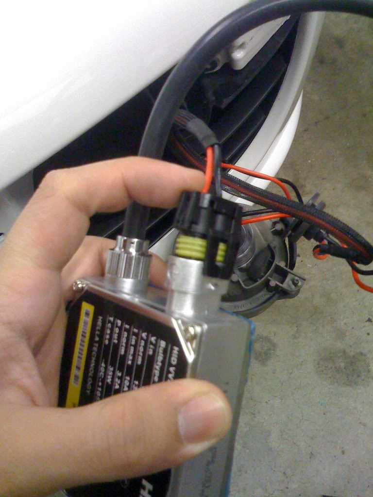

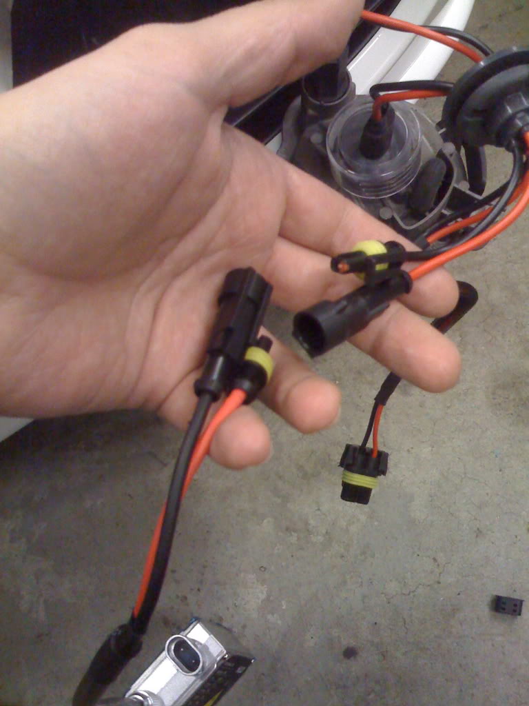

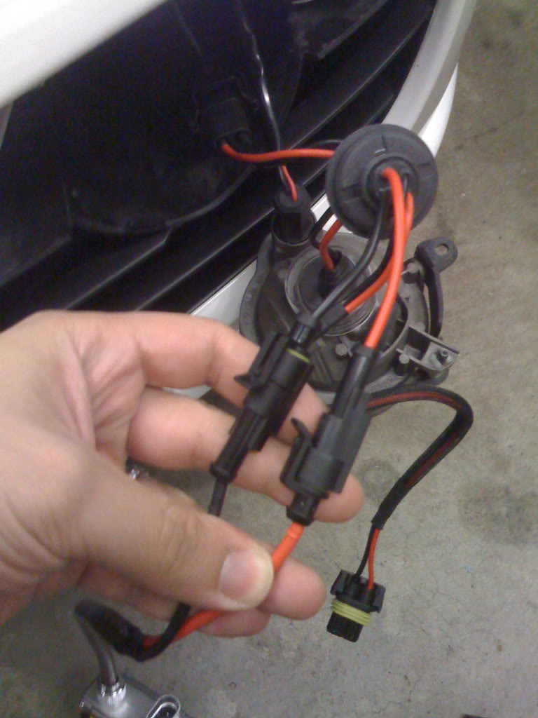

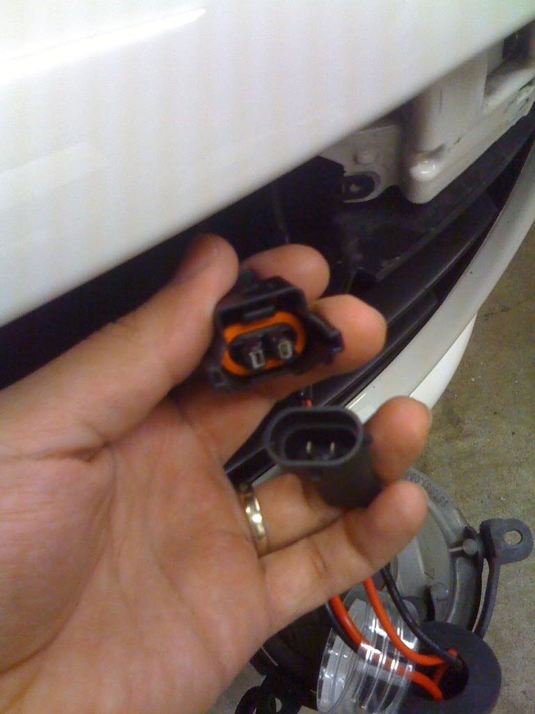

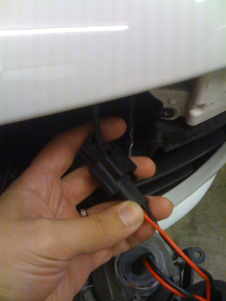

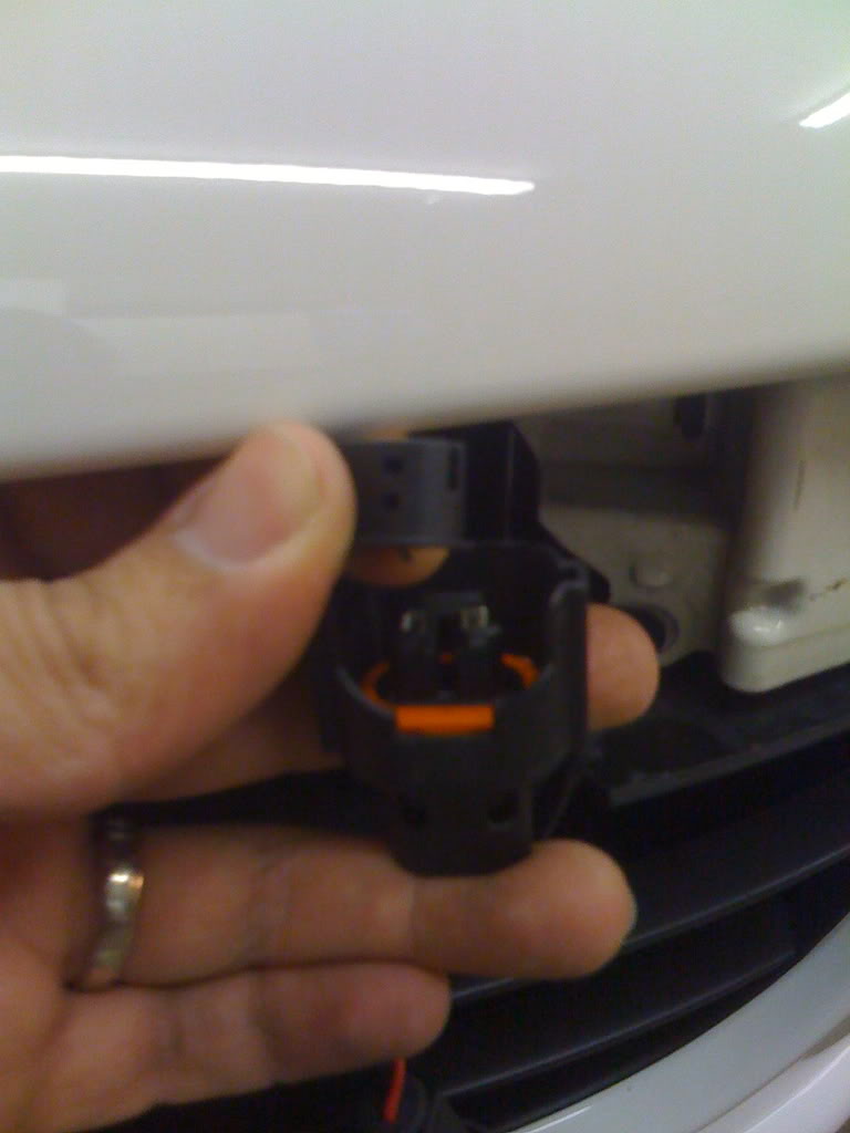

connect the clip from the kit to the factory bulb harness, removing that little cover allows it to fit.
now connect the positive and negative clips to the HID bulbs, red to red and black to black.

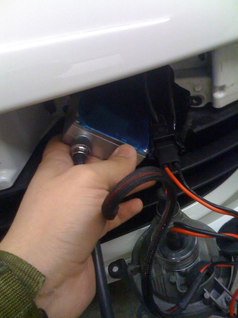

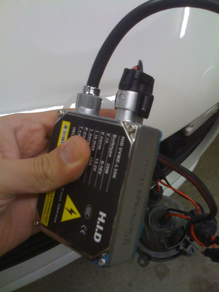

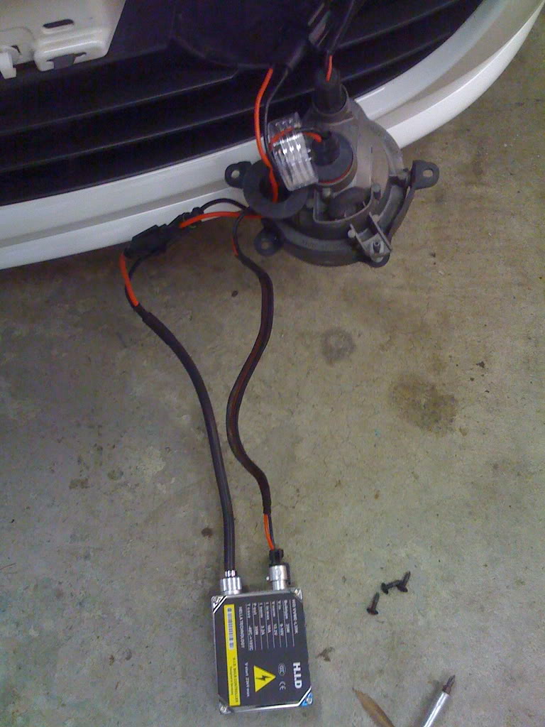

now connect the ballast clip with the clip snap facing out (its the only way it snaps in)
your set up should look like this.

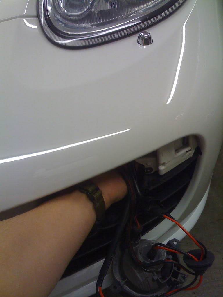

I used 3M double sided tape to secure the ballast, it fits right in front of the headlight washers inside the bumper cover.

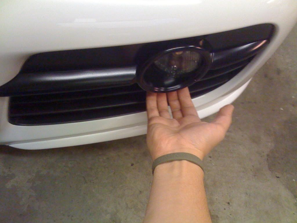

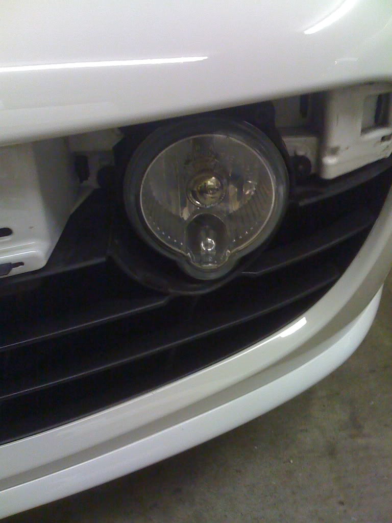

put the foglight housing back in.

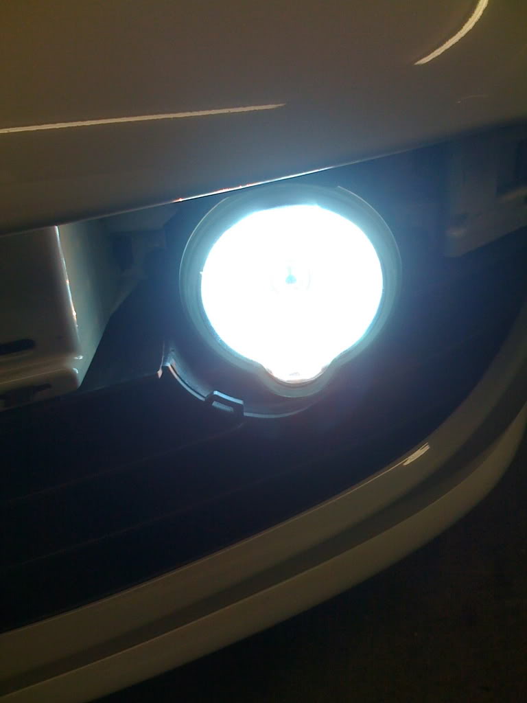

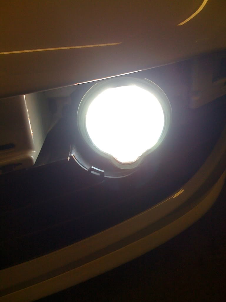

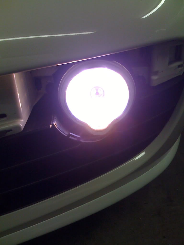

press your key lock button to make the lights come on...of course xenons change color from purple
to blue...
to white when they are first turned on. This is normal.
the lights are perfect.

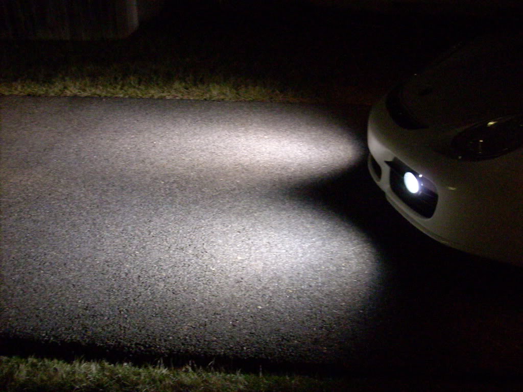

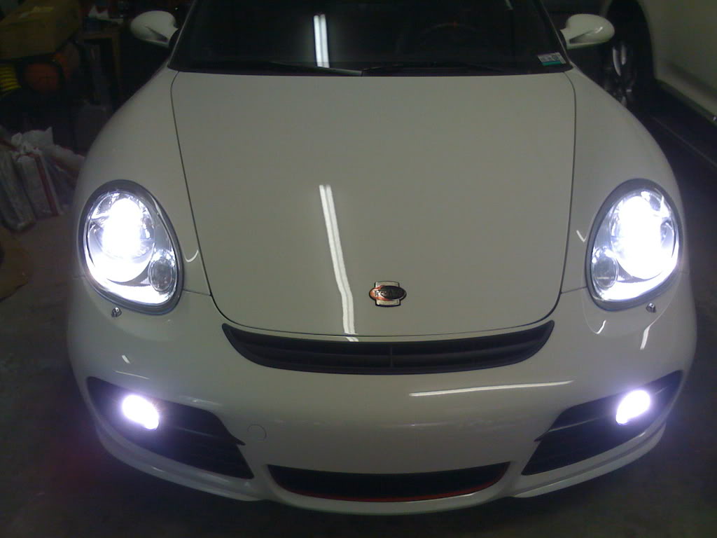

The lights are bright, perfect for those foggy nights, or rainstorms. These pictures are only with the foglights on.
only foglights...
only foglights...

I got the HID foglight too in my Cayman but seems that the output is not as bright as yours. I bought Japanese kit not such knockoff. Also the light outlines are not as neat as yours. Yours looks perfect.
Might be the angle of the foglight. Do you adjust yours?

did you get 4000K, 6000K? mine is 6000K, you can adjust the height using a phillips screw driver.
