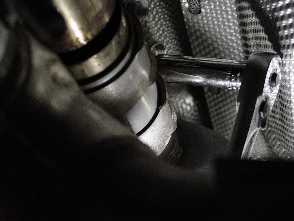

No need to jack up the car just get your 13mm deep socket and wrench. See the cross over pipe over the tip.
Loosen the two 13mm bolts.

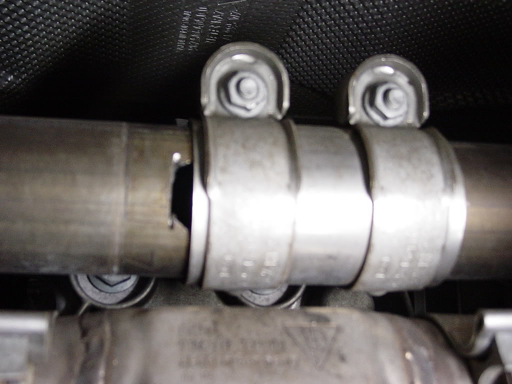

wpmjr cut the end of the pipe and it helped reduce drone. Here is an example of what he did. The red line shows where to cut.
It seems that there are slight differences in each exhaust or how they are fit because mine had a larger gap already. Another good idea would be to cut a triangle or U out so you can use the sleeve to adjust the sound by sliding it back and forth. Thats what I did here:
You can see now it can control the sound better, it also eliminates drone.
Now tighten both bolts again, so they wont rattle or fall off. The sound is alot louder and deeper. It only takes 5min. These video clips kinda suck but its better than nothing.
