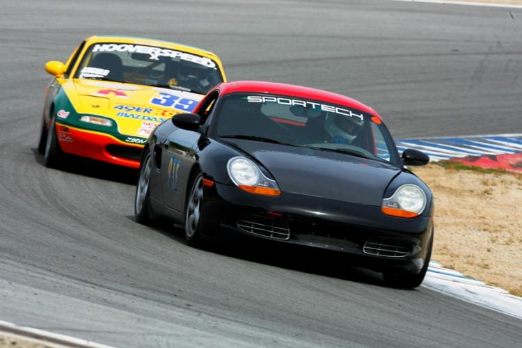

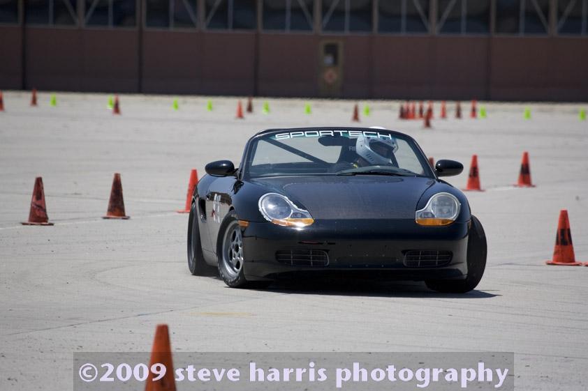

Here is my 99 car in both Track and Autocross trim
Track gets hardtop, 17x8.5 rear with 255/40/17 BFG R1, front 17x7 with 225/45/17, KW Variant 2 coilovers, GT3 front sway, Tarret rear bar,tarret end links, GT3 camber adjustable front control arms, CF hood, TC Design Fab Rear cage. Lightweight flywheel, Wevo engine and tranny mounts, Hawk blue pads on stock rotors, Stock 2.5
Autocross top comes off and 15x7 Phone dials go on with 23x9x15 R250 compound Good Year Race slicks.
Car weighs about 2300 lbs.
