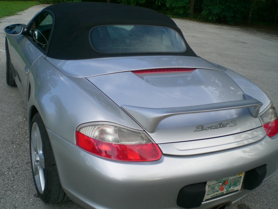

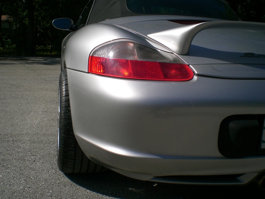

you will need a large spacer and under extreme load the fender will rub in the back, the front will also rub unless you put a smaller tire on it such as a 225 18 this picture shows a Carrera 11" wheel on the back before I widened my fender, at DE's it rubbed (not during street driving)
second pictures shows widened fender
