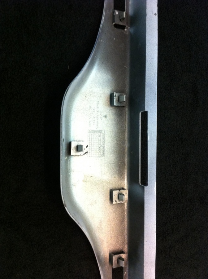

Hi
I am changing the belt in my 06 Cayman and am taking the front carpet off, but i can't figure out how to get the top plastic part off. I've got the little luggage bar off but I can't see how the plastic below it is attached. I don't want to break it.
Any help would be appreciated

The metal clips fit tight and the plastic can bend some. A putty knife or a screwdriver should do the trick.

on my gen 2 i had to use an old gasket scraper and pull on the carpet at the same time.
