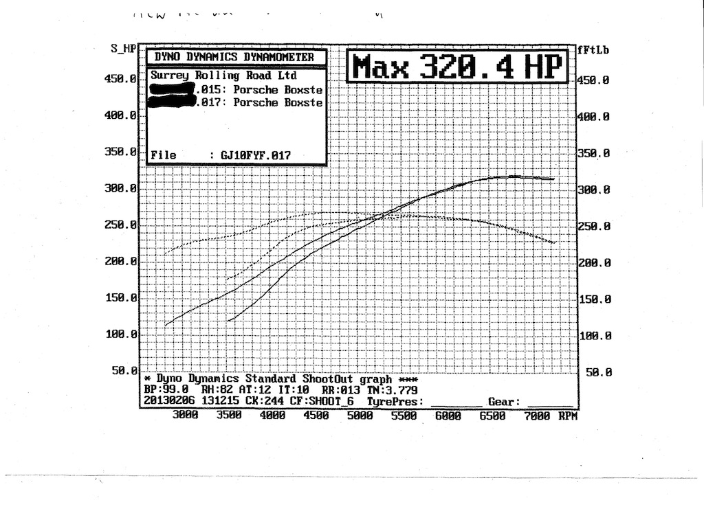

Anyway, I was thinking that I wanted a bit more volume than the PSE offered, and I decided on an Innotech Performance valvetronic exhaust. This would make the car louder, maybe add a few hp by improving airflow and retain the switchable functionality of the PSE. I had it installed by Rebellion Automotive in Portsmouth, UK, under the supervision of their CEO, Phil Deacon. Phil had his engineers connect the exhaust valve to the existing PSE button, so the car still felt completely standard. This lost the Auto mode on the IPE (in which the valve is closed at low revs and opens at a user-set threshold), but I figured I would either want the thing loud or quiet and knew I wanted as few extra buttons on the car as possible.
The exhaust sounded great (there are some clips on Rebellions' facebook page - to follow!), especially from outside the car or with the roof open. From inside with the roof closed, I did initially worry that it was too loud, especially at about 2,000 rpm, which equates to 70mph in PDK 7th gear. Whether due to some sort of 'bedding in' or my just getting used to it, however, this ceased to be a problem after about 500 miles. What continued, however, was the marked improvement in performance between loud and quiet modes. I really felt this at low revs: with the valve closed, the car took off at 4,000rpm; with it open, it took off from a standstill. To be completely honest, it felt as if the car was slightly faster than before in loud mode, but actually slightly slower in quiet.

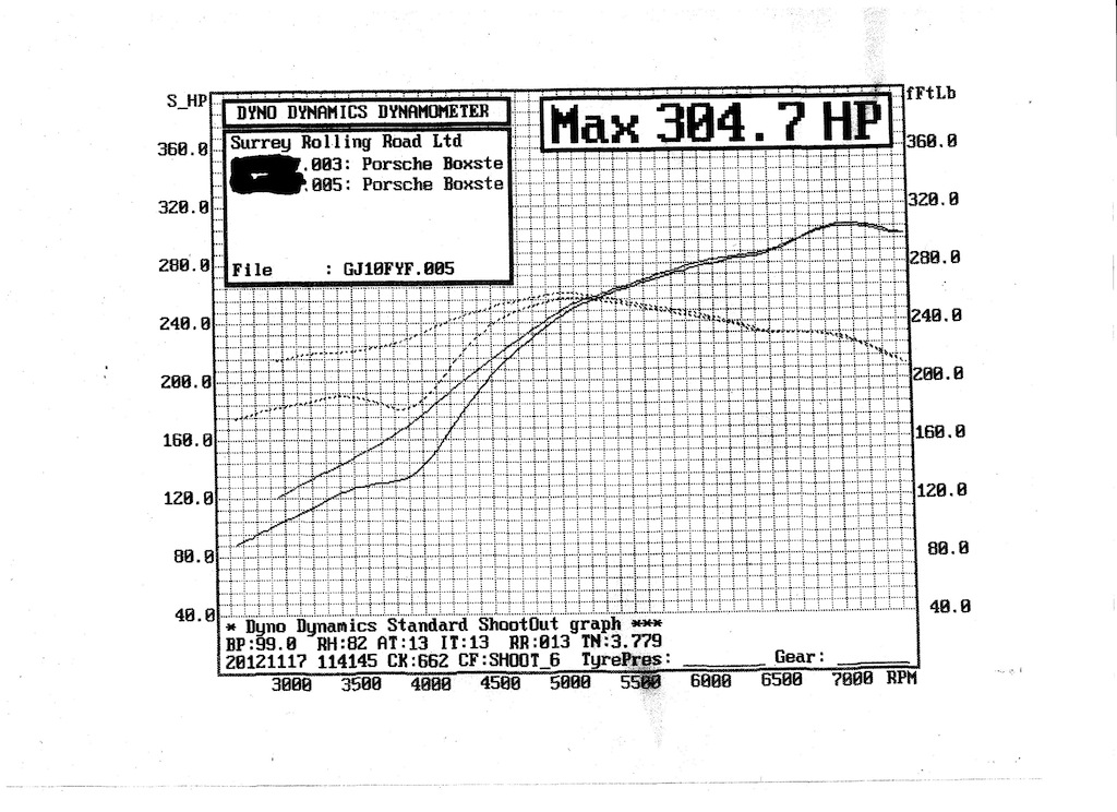

So, last November, I went here
http://www.surreyrollingroad.co.uk/
and took advantage of their £40 Saturday deal. We did one run with the valve open and one with it closed and achieved the following readout
Name:  oldop vs oldcl.jpg
The top line is with the valve open, and the bottom line with the valve closed. There is a clear difference at lower rpm.
What was a little surprising given the amount of things done to the car was that the car was producing no more hp than stock (310, apparently, for a 2010 Boxster S) and actually slightly less. Phil at Rebellion said he could retune the car (remember, it already has a Softronic tune on it) to take advantage of the Innotech exhaust and that he thought we would see some gains.
So that's what we did. Before I get into the details, it's important to say that the Innotech exhaust was put on *after* the Softronic tune, and it's quite possible that the two just didn't go together that well. I stand by my earlier positive review of Softronic and regret that I didn't get the car dynoed with that tune and the existing PSE. That said, Softronic's FAQ states the following

Phil of Rebellion came up to London and gave me a favourable deal on a performance tune for my car and an economy tune for my girlfriend's Mini Cooper. Rebellion use a slightly bespoke (I think) product from Viezu Tuning, here in the UK. The first thing to say is that having a readout and remap done by a professional while I watch and we both have a coffee is far less nerve wracking for a non-technical person like me than using girlfriend labour and a knackered laptop as I did before. The whole process took about an hour and, for the two flashes, cost less than the Softronic did in the first place (yes, this has been an expensive experiment. Hope this review provides useful guidance for others considering it!).
There is a video of the car post-flash on Rebellion's facebook page, here (you have to scroll down a bit). I'm afraid it was in a 30mph limit street so you won't get the full flavour, but hopefully it will give an idea.
http://www.facebook.com/RebellionAut...ref=ts&fref=ts
The heading is 'Mapping London client's Boxster S fitted with IPE'. Rebellion are an expanding company and doing a lot of stuff in social media, so if you like what you see please do click 'like'
The car immediately felt sharper and faster, but I had become addicted to hard data, so it was back to the Surrey Rolling Road to get it tested. The comparison with valve open of the Softronic vs the Viezu/Rebellion map is here:

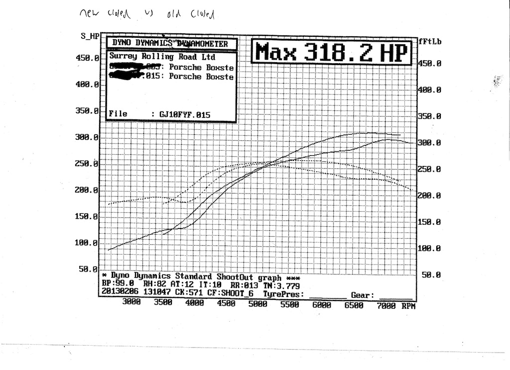

The difference was also marked when the valve was closed

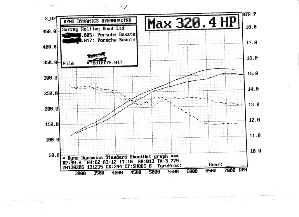

I noticed that the new curves, as well as having a greater area underneath them, were smoother, especially higher up in the rev range. This, apparently, is to do with the fuelling. The Rebellion/Viezu tune injects more fuel when it is called for at higher revs, as shown below. This is the readout of hp vs air/fuel ratio, with the valve open and the old vs new tune.
Name:  newop vs oldop (f).jpg
This explains the only negative about the new setup, which is that the car seems to have gained the capacity to singlehandedly rid the world of fossil fuels. I swear that if I drive it hard I can see the petrol guage falling like a suicide from the Enron tower, BUT you don't have to drive it like that(BUT you always do...). Apparently if driven conservatively it should use less than a non-tuned car.

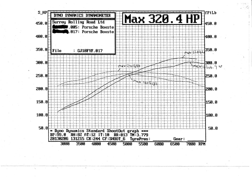

The final chart, for those interested in IPE products, shows the difference in output, with the new tune, between valve open and valve closed (basically it's a new-tune version of the first chart).
Name:  newop vs newcl.jpg
The difference at high rpm is very small (2hp), but the low-end change is considerable. The nice change from PSE is that the button now enhances performance as well as sound, and the sound is a good deal less subtle! One point to note is the effect of the valve renders IPE's Auto option (where the valve opens at high revs) a bit unnecessary, as low revs is where the big gains are. Overall, the car feels like it's really performing to its potential now, and I am very happy with it.

Car has about 22,000 miles, and no. The wheel hp readout was 265.3.

A very interesting post yet the chart that shows what our AFR's had been at in run 5 compared to the final run of 17 seem to be off or run 17 was in fact running lean. None of our DFI flashes run that lean of close to 14.0 AFR's as shown. The stock cars will run down to 12.0 and as low as 11.0 afrs in the DFI at WOT. This is obtained under load and above 4k in which they will flatline at that point. Leaning the car out will gain more HP yet none of the 50 Race cars we have tuned and dynoed run that lean. Running them to lean can cause engine issues. The car that we just tuned recently that won the 24hrs of Daytona in GX only ran as lean as 12.8 afr's for the full load range.
The HP figures also seem low from all of ours and NPR's runs. The PDK's are very sensitive to runs on a dyno and will at times go into a limp mode and reduce power dramatically. They also have to be run on linked AWD dynoes as non linked ones will cause this. Our gain changes in these cars have been 30 WHP and show this easily on the track from non tuned cars of the same series. The Daytona car put down 420 at the wheels yet that was a Cayman converted to a 997X51 engine.
I would almost think that run 5 was stock and run 17 was a tuned file yet you have a good amount of mods for about a 10hp increase. Another posted 255 stock on the same dyno to your 265 tuned etc. I would like to have seen a read out of the DME prior to it getting re-flashed to check.
