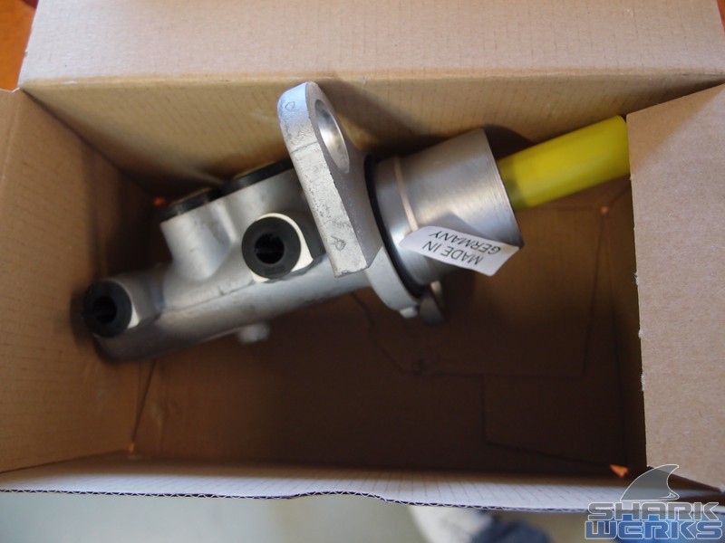

The first port of call is the upgraded brake master cylinder, from a Gen2 GT3 with PCCB's:

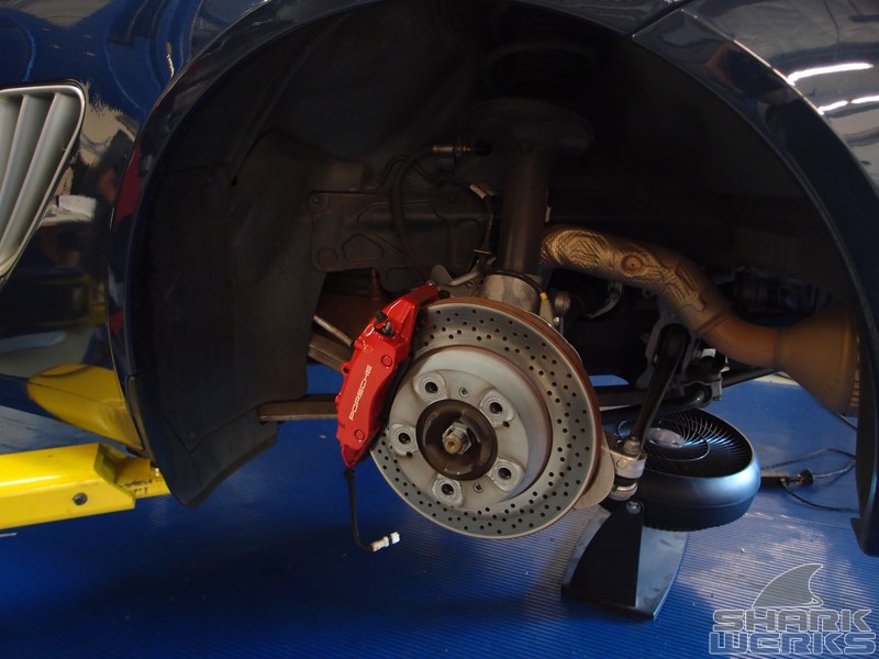

The fronts are the very same brakes as on the 2006 Cayman S when it was first introduced. With the additional power and improved suspension Porsche really could have upped the ante for the Cayman R model...

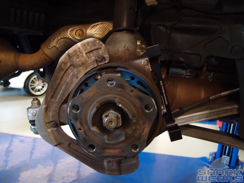

The stock rear rotors were very worn and ready to be changed:

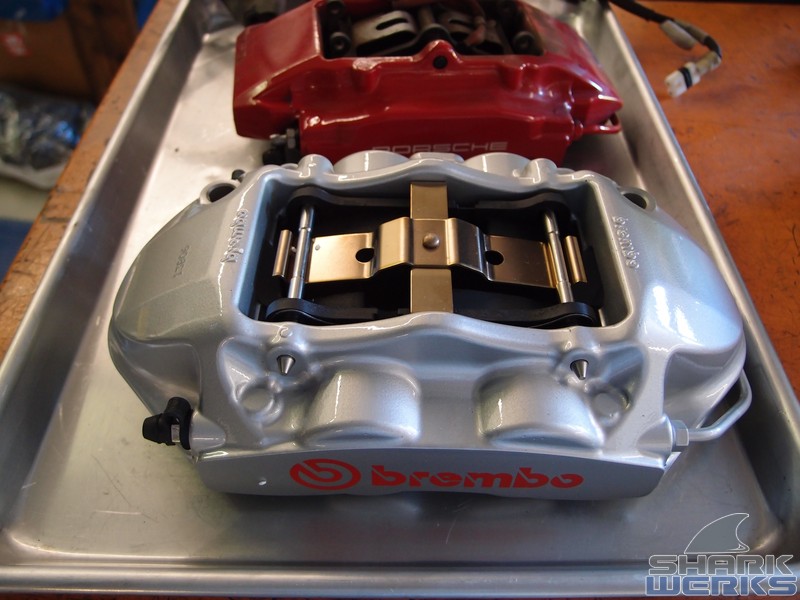

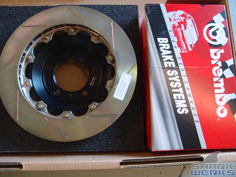

The Brembo goodies awaiting their turn:

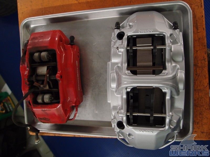

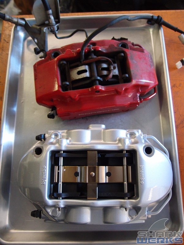

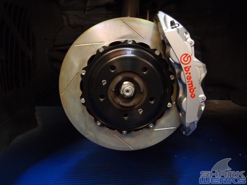

The much larger and now 6-piston Brembo caliper vs smaller stock 4-piston:

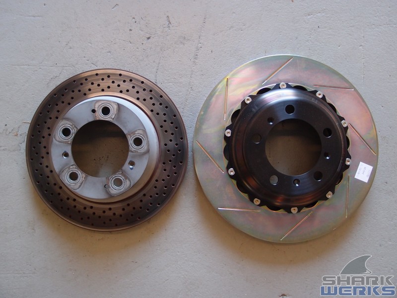

Two piece slotted rotor with way more surface are vs the stock drilled and tired one...
Thicker and yet lighter too!:

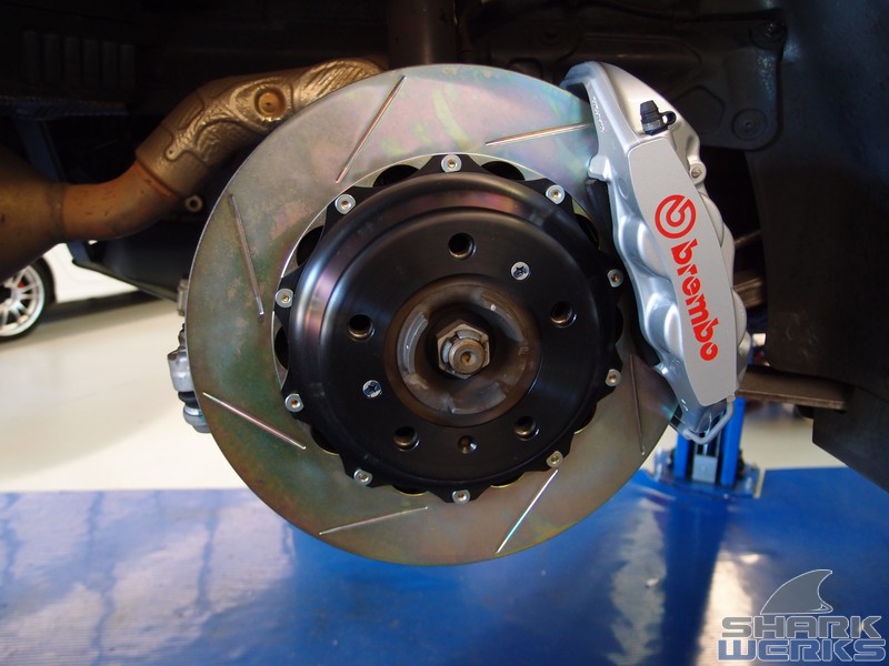

Even the new 4-piston rear caliper is considerably larger:
Garnished in silver:

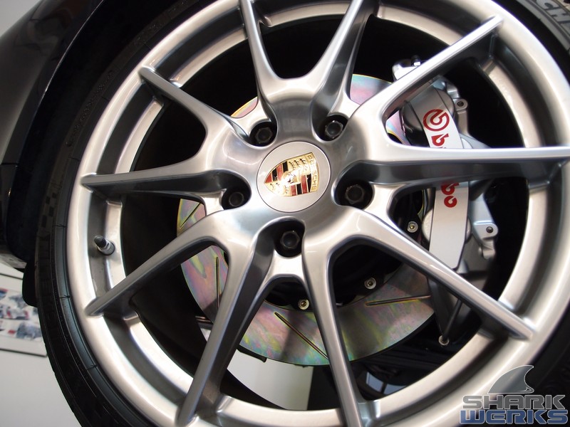

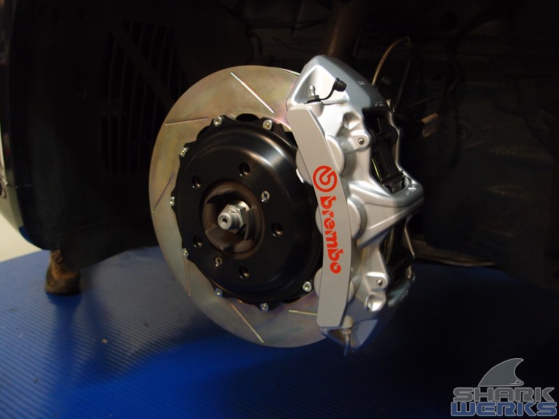

Fronts installed:
Rears being installed:

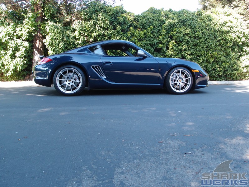

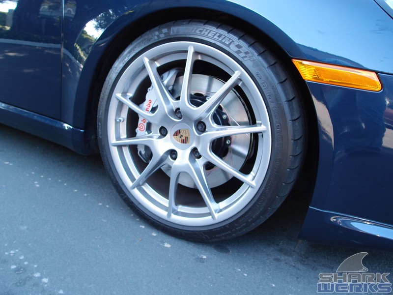

The stock 19 inch Cayman R wheels are some of the nicest factory wheels Porsche has ever had so no changes there. Fitment is a-ok with the larger brakes:
Ready to go hit some local NorCal tracks... only this time armed with a more consistent brake pedal, improved cooling (to help deal with traction control brake wear interference) and way more bite!
