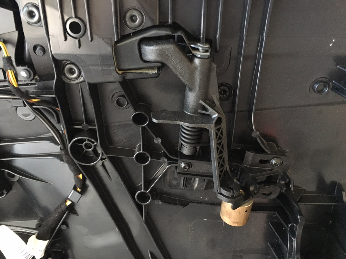

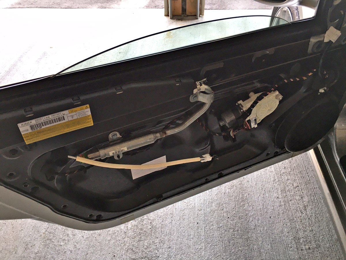

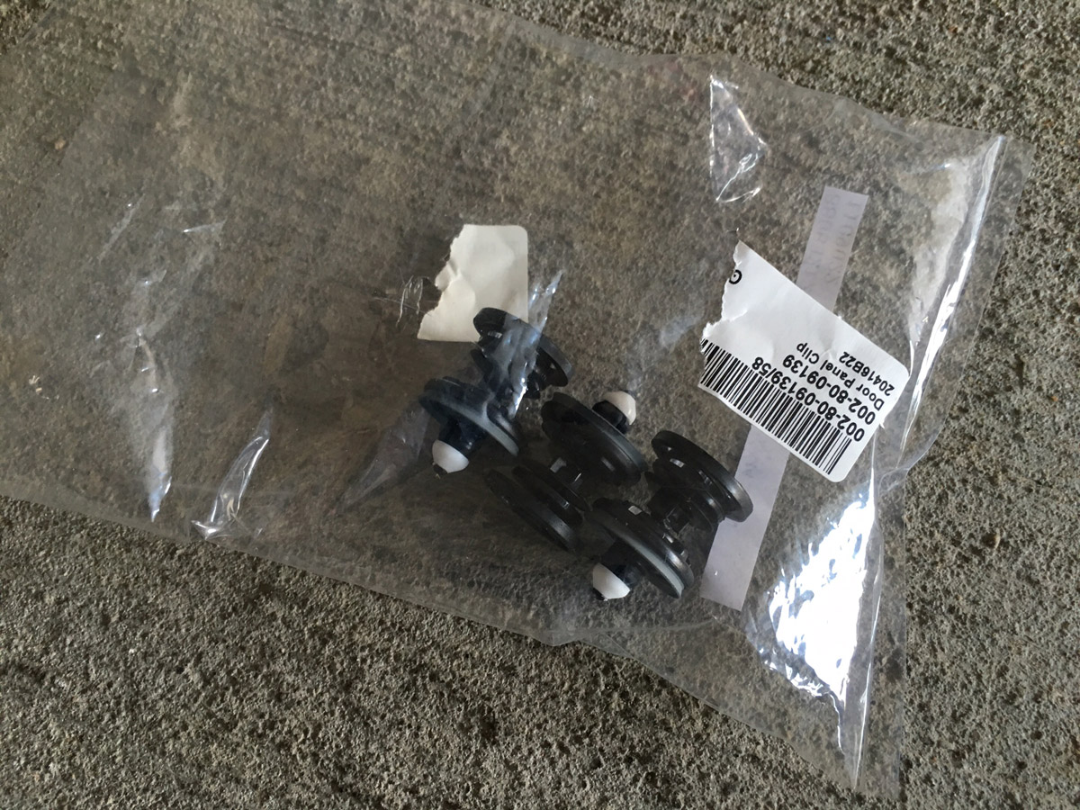

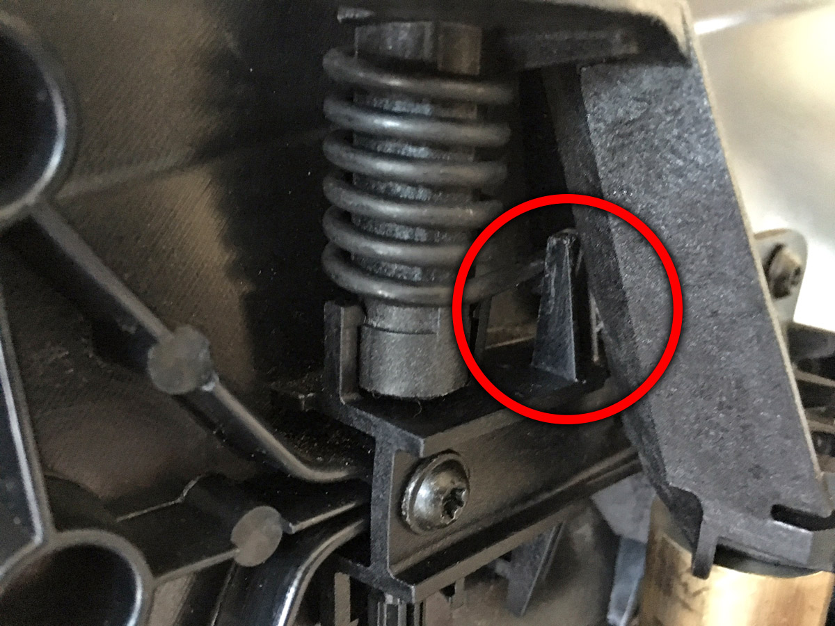

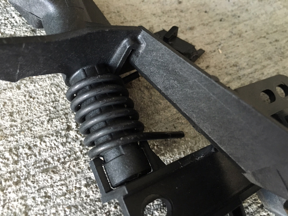

Yesterday I fixed my driver's side interior handle. When I picked up the car the handle was loose and the window would not return/seal after closing the door. I removed the door panel off and found that the spring that pulls the handle back against the door panel had popped out of it's spot, I managed to get it back into position but the plastic that held it in place was bending and weak from years of fatigue. 2 weeks later the spring let go again, this time the plastic piece that held the spring in place snapped off.
I ordered a replacement lever + some door clips (I broke some the first time I had the door panel off) from pelican parts for about $90cad shipped. The part has an updated design and requires a new cable, but I was able to separate the top from the bottom of the assembly and use the lever portion from the original handle. This eliminated the need to replace the cable.
Here are some photos of the pieces and the culprit:

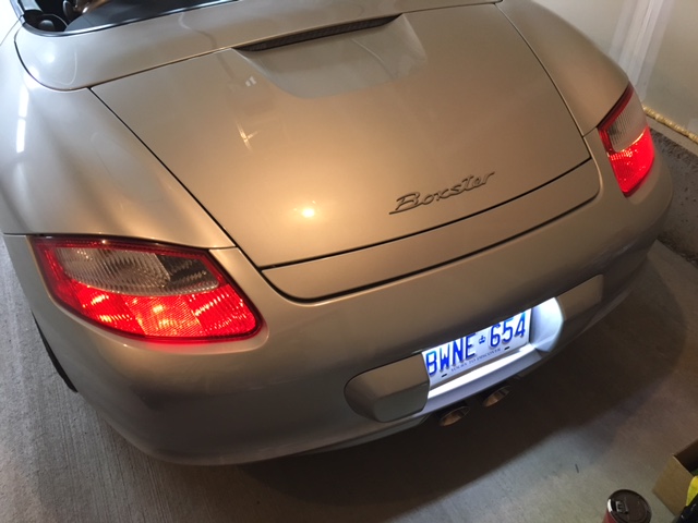

LED License Plate Lights
Minor update:
Porsche stickers are on the calipers (still need to take photos). Also, this morning I installed LED license plate lights (complete assemblies), they are much brighter and give the car a more "up to date" look. Here are a couple photos:
