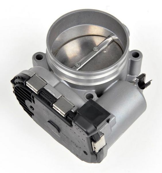

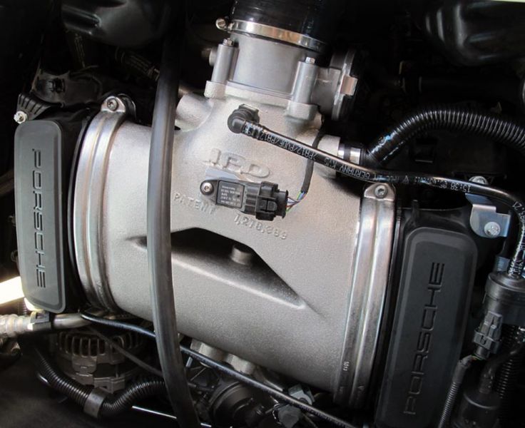

However, when the 3.8L motor was installed in the 981 chassis, it lost the 82mm throttle body from the 991 Carrera S and instead received a smaller 74mm throttle body and matching plenum. IPD's Competition Plenum rectifies this problem, allowing installation of the 82mm throttle body and improving airflow through the plenum to allow for a significant improvement in performance.
To allow the engine to take full advantage of the plenum and throttle body, custom application-specific EVOMSit software was developed for the EVR425 package. The result is a smooth and steady increase of 20-30hp across nearly the entire rev band and no fault codes or check engine lights. The software is available in 91, 93, and 100 octane (95, 98, and 102 RON) variants, and incorporates Intelligent Tuning's Integrated Switching Technology to safely and automatically adapt ignition timing to deliver the most safe performance for your fuel and conditions. Options such as left foot braking and a raised rev limit are available upon request.

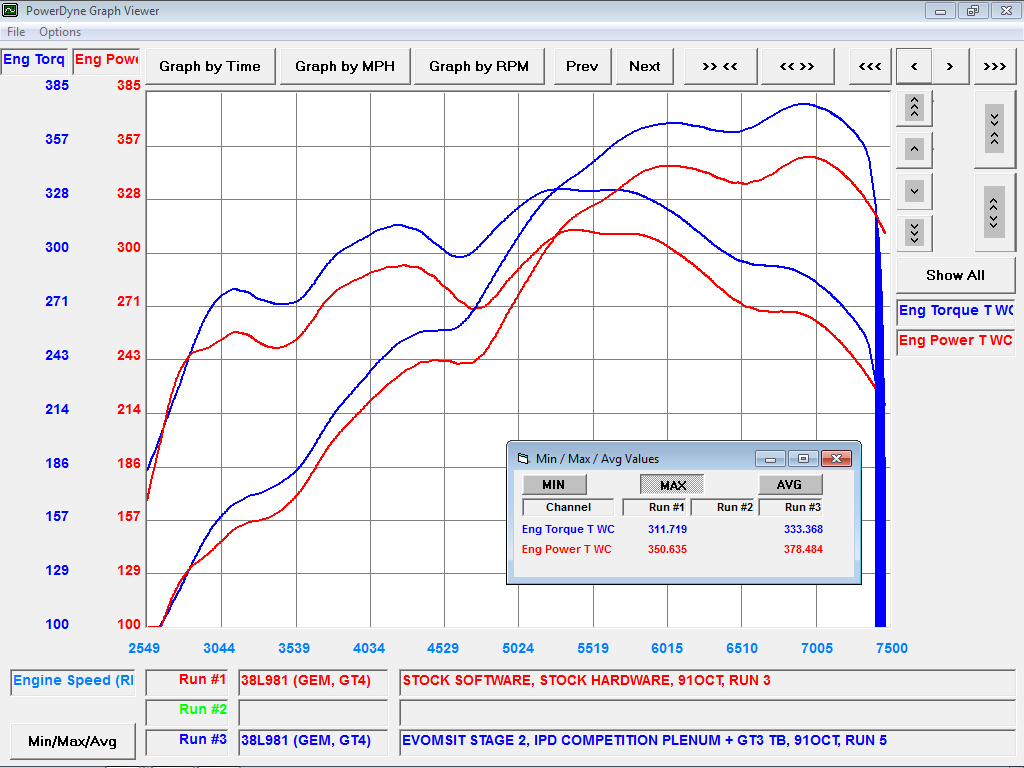

Stock GT4 Power: 385hp, 309lb-ft
EVR425 Power, 91oct: 416hp, 335lb-ft
EVR425 Power, 93oct: 424hp, 340lb-ft
Peak Gains AT THE GROUND (divide by 0.909 to estimate flywheel power):
vs stock: +22lb-ft, 28hp
At 3500rpm:
vs stock: +20lb-ft, +13hp
At 4700rpm:
vs stock: +30lb-ft, +26hp
At 6000rpm:
vs stock: +21lb-ft, +24hp
At 6500rpm:
vs stock: +23lb-ft, +29hp
At 7200rpm:
vs stock: +22lb-ft, +30hp
