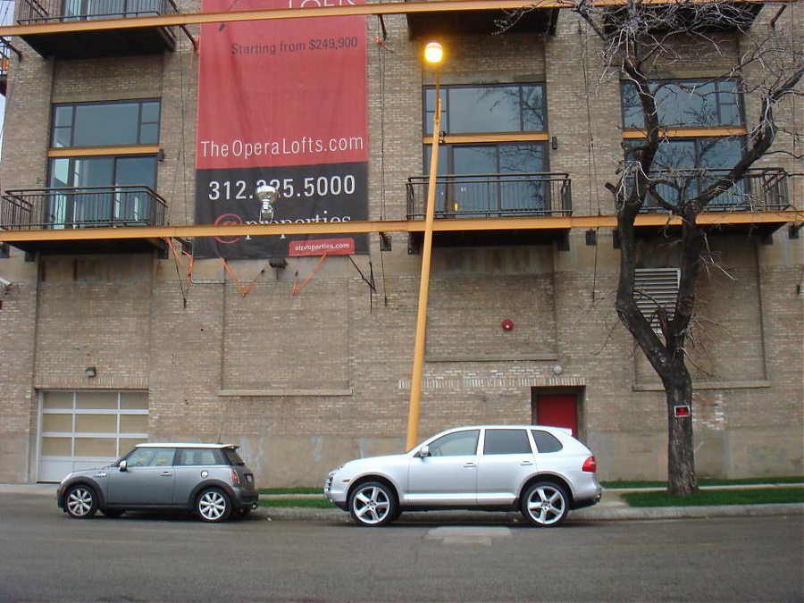

i am interested in one of those, also, can you please send me the details on my email adress?
thank you
ps: here is it "reason" why i need it
https://www.6speedonline.com/forums/...4&d=1210061101
