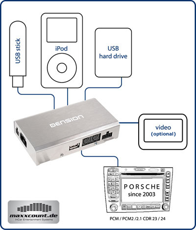

and if you wonder what I will use for different add on's, USB also so I can play directly from MEMSTICK , also it has a very nice feature - you can play the videos from the iPOD so here is the almighty adapter I have found, and costs no more than 419 eur:
564 GATEWAY 500: iPod factory car radio set for all Porsche starting from 2003 with MOST-BUS
With the GATEWAY 500, we are presenting the first iPod adapter for all Porsche with Headunit- / Navigationsystems CDR24, CDR23, PCM 2 or PCM 2.1.
The iPod adapter supports the amazing sound potential of the iPod in a perfect way. Furthermore, the GATEWAY 500 provides a comfortable controlling of the iPod via the steering wheel remote control or the PCM / CDR. With all PCM systems the CD text information from the iPod is displayed on the navigation system.
Besides the comfortable iPod integration, the GATEWAY 500 is equipped with even more interfaces for additional devices. Via the integrated USB port with charging, i.e. USB sticks or portable USB hard drives for music play back are connectable; in order to enhance the capacity of the connected iPod. The audio line-in (AUX-IN) facilitates the connection of further external multi media components like a DVD player or a PlayStation, as well as a voice recorder or a PDA with Bluetooth® wireless technology via maxxcount CarKit Blue. With the additional data line-in the GATEWAY 500 is prepared for any future enhancement options.
No matter which components are supposed to be connected to the car - the GATEWAY 500 definitely captivates with its outstanding universality. By that, it appears as the ideal multi media interface for all Porsche models with optical data bus MOST.
Features:
iPod control via the original car radio or the steering wheel remote control
Conserves the rechargeable iPod battery by a intelligent charging system
USB host connection for several USB mass storages, e.g. USB sticks and
USB card readers(supported formats: mp3, WMA, OGG)
AUX line-in via 3.5mm to RCA
Accessories:
You want to play back your iPod videos on an external monitor ? Here you will find the DENSION Video-Adapter for GATEWAY
For a detailed description please go to Basic-Info GATEWAY 500.
