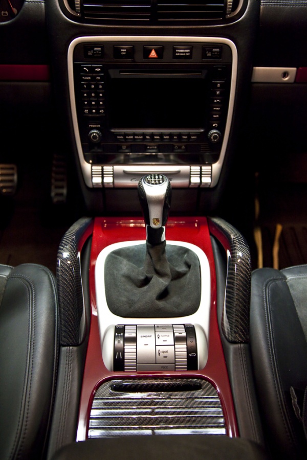

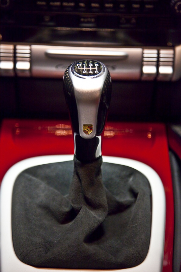

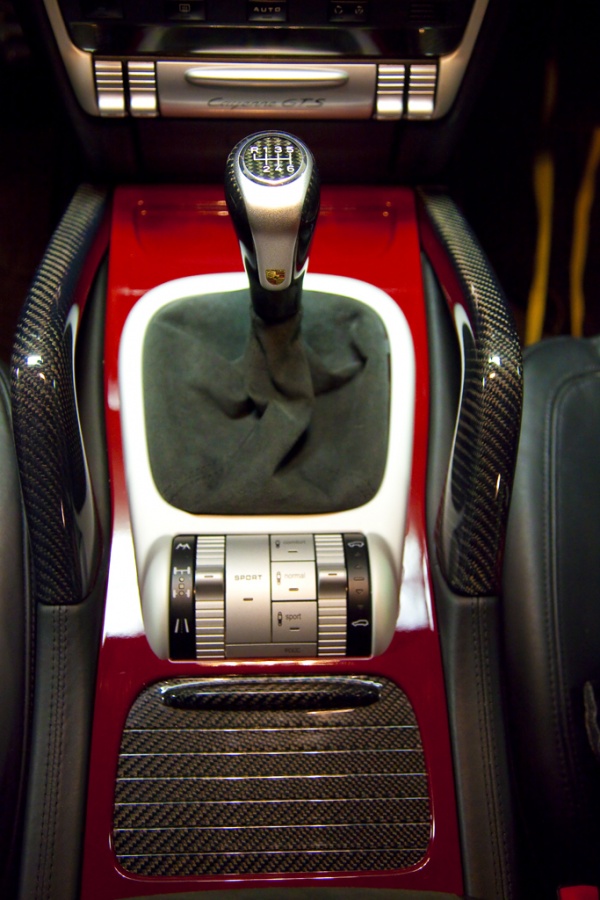

After searching far and wide for a suitable CF replacement for my stock manual shifter and finding none, I decided to modify a Boxster/Carrera one purchased from Suncoast.
Here are the results:

This new **** is amazing. It's much more substantial than the stock, heavier and larger. Shifting with it is a joy.

i have an extra cf **** and have been wondering how to get it swapped. our dealer couldn't say how it would fit. i don't they had seen the **** off a manual tranny
machining required?
i love the red trim on your GTS - the cf drink cover slider is really nice

It looks great! Can you tell me where did you get the center console cup holder's CF slide door? tks

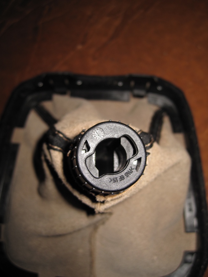

2) Release the lock ring - At the very bottom of the shift **** assembly there is a ribbed lock ring which can be rotated 45 degrees clockwise to unlock it from the mounting post

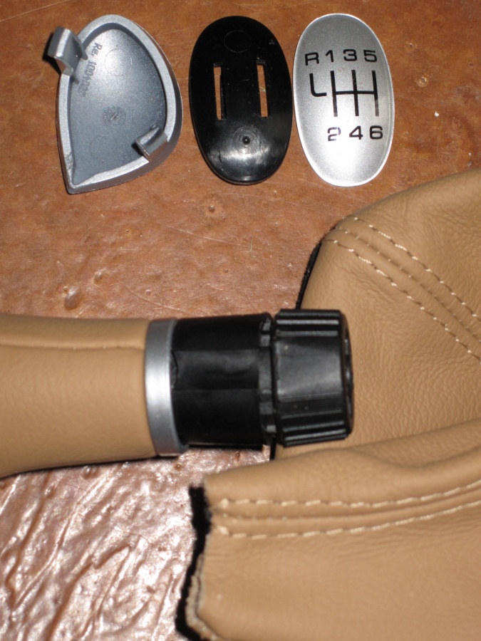

3) Access the upper attachment - Remove the plastic covers (see 5) on the top and sides of the **** with a small screw driver. This takes a minimal amount of force.

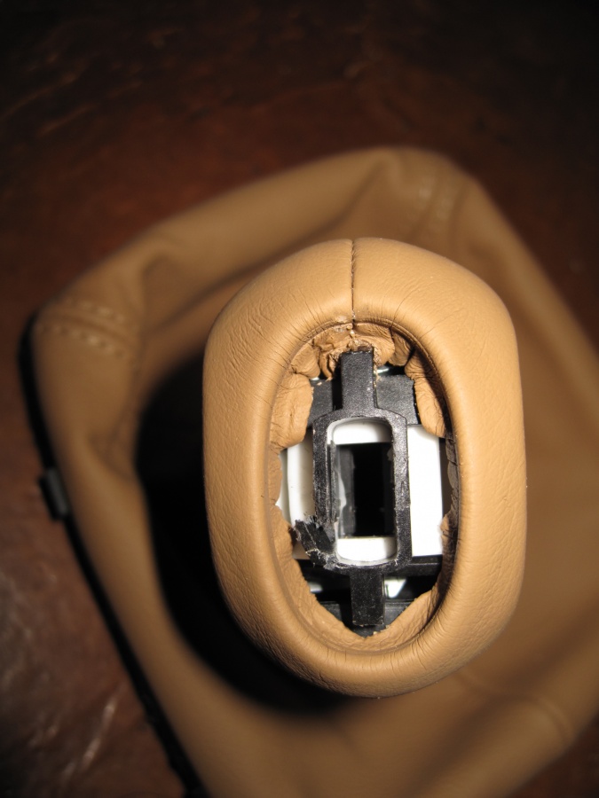

4) Release the upper attachment - The **** is now held in place by a metal (mounting post) to plastic (white plastic tabs as seen in the picture) push fit. To release the ****, pressure must be applied on the plastic tabs outward while pulling up on the ****/boot assembly. This took a quite a bit of force, but once released it will come off easily (managed to hit myself with the **** just above my right eye).

5) Separate the boot from the **** - A plastic ring just above the lower locking ring of the assembly holds the boot in place (see picture). Invert the boot and gently pull on the boot after rotating the plastic ring to release the boot.

From there, attaching the new shift **** was simple. The boot on the Boxster/Carrera **** was held in place by a zip tie which I cut. I attached the Cayenne alcantara boot the CF **** with a new zip tie being mindful of the correct orientation of boot to **** to center console. The new assembly fit perfectly onto the mounting post. Tightening the allen set screw, firmly secured the **** in place.
There you have it!!! Not too difficult and only required a couple hours for me to do. Should take you even less!
Purchased from DB-carbon Interior out of Germany. They have a plethora of CF parts I have not seen offered anywhere else. After ordering it, I received it in a couple of weeks.
