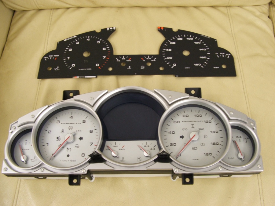

yesterday we chainged the dials in my friends turbo for the gambella ones in silver (to match his silver/grey interior)
but there are subtle differences
can you spot them?
2 are quite major.
it was a 15 min job to take the clocks out of the car, and a 2 min job to change the dial foil over.
easy.
he has a brand new white set (unopened) for sale , not gambella, just white with grey numerals, and not foil but a high grade plastic, very professional.
pm me for details.

yes the top cowl has to be "lifted up" or taken off, its 2 torx bolts at the top on the instrument cluster, and 1 at the very back (top)
it could not be easier.
i used 1 flat screwdriver and 1x 20 torx. 15 mins tops.

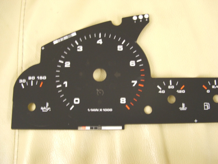

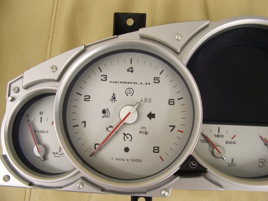

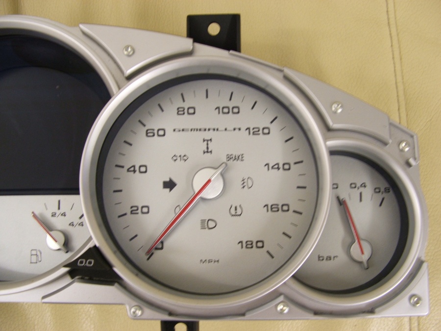

the differences are
engine temp and water temp are now in F instead of C (as you spotted)
the hand brake symbol is different now saying "BRAKE" instead of the round brake symbol.
now reads ABS instead of the ABS symbol
different low tyre pressure symbol
difflock symbol is different.
the needles are a different colour also (now red instead of orange)
there is one problem on the car that has been changed from S cluster to Turbo cluster (we have done 3 cars this weekend)(2 turbo's & 1 S)
when before mark selected "miles to go to empty" in the comsumption menu it would always stay there when he turned the engine off (ie: when he restarted the car it would return to that setting)
now, it returns to the speed (av mph) setting every time, its only 1 push of the button to get back to miles to go, but it is a glitch non the less.
no issues with the air suspension etc, everything working.
on the 2 turbo cars it was a bit more straight forward as it was just the foil that was changed for the gemballa ones.
it was the S car that had the compleate cluster changed and had white foil put in in place of the booring black.
it has made all 3 cars look much fresher.
very simple job but if im honist a bit expensive for a bit of foil.
