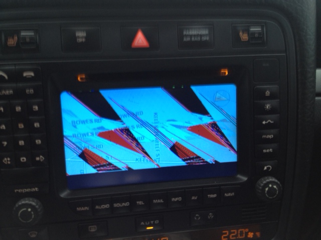

Hi, I am just curious if when your screen began to fail it looked like this

Mine just went dark! It occasionally comes on for a day and then gone.

Wow, that is whacked

I changed my screen. So, apparently it's something else. I saw somewhere in the forum that the soldering on some board is detached. Mine actually quit for about a year then came on perfectly one day when I charged the dead battery!
