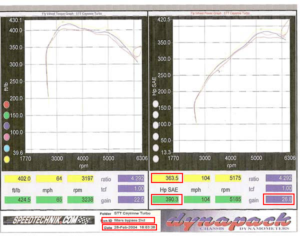

Let's take a look at the Fabspeed Cat Bypass dyno sheet (since I don't have mine yet) and make some assumptions.
Based on Porsche's SAE net corrected flywheel horsepower (HP) number for a 955 CTT at 450 HP in stock configuration. Here are some calculations based on the Dynapack runs they (Fabspeed) did:
For the run above, stock wheel horsepower for the example car (and obviously this number would vary from car to car, but usually not too much) was 363.5 HP. We can deduce fairly easily that the car was most likely stock as advertised by factoring in a 23.97% AWD drivetrain loss. So HP measured at the flywheel would be 363.5 HP + 23.97% which is 450 HP right on the nose.
The run included filters + Fabspeed Cat Bypass pipes (if you read closely) and bumped HP at the wheels (really the only number that counts) from 363.5 HP to 390.3 HP, a 26.8 wheel HP gain over stock. Using the 23.97% AWD drivetrain formula above, the car would now be 483.5 HP at the flywheel. So a 33.5 HP gain as seen at the flywheel.
I can tell you that these numbers are definitely on par with my car based on the "butt dyno" alone. The Fabspeed Cat Bypass pipes are an absolute must and they work.
I don't have any IPD example dyno runs to extrapolate from, however, let's make some assumptions again. I have spoken to IPD and can tell you that the 30+ HP claims for the IPD plenum were tested on a totally stock 955 CTT and as measured at the wheels.
So let's say we put the IPD plenum on the test car above without the Fabspeed Cat Bypass pipes. While it's a completely different car and would quite likely render a different wheel HP number than 30 HP (though likely not too much); adding the Fabspeed Cat Bypass pipes would be mostly additive in the literal sense.
This is because the main HP gains from the IPD plenum aren't from exhaust flow but from charge air cooling (almost like a 3rd Intercooler) and air channeling. As an interesting example of this, go run your car really hard once the plenum is installed. Then pull over and pop the hood. You will see that the plenum is pretty much ice cold compared to other engine components!
When you add the Fabspeed Cat Bypass pipes, you're greatly improving engine breathability so these two mods (three with some BMC filters) really can be looked at additively.
So for example, let's take 390.3 HP + 30.0 HP is 420.3 HP to the wheels. So flywheel corrected HP is 420.3 + 23.97% (AWD drivetrain loss) making 521.04 HP at the flywheel.
Now, given that dynos, dyno runs, and cars vary and this is very theoretical, it's safe to assume about a 15 HP variance from the top of the 521.04 number and down (506.4 HP). The point I'm making and will hopefully be able to demonstrate conclusively soon with my own dyno runs is that a stock 450 HP 955 CTT in good mechanical condition should be bumped to well over 500 HP with these mods alone.
