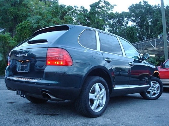

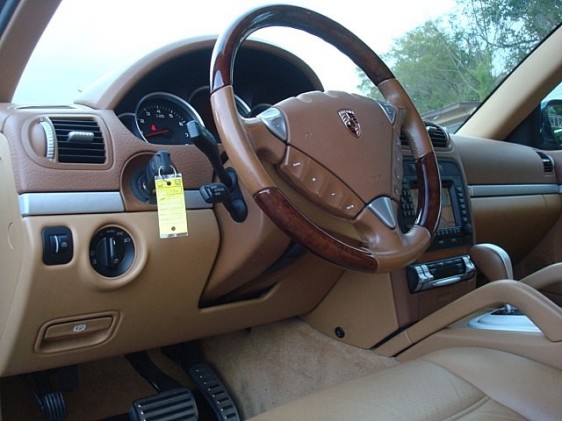

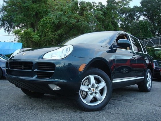

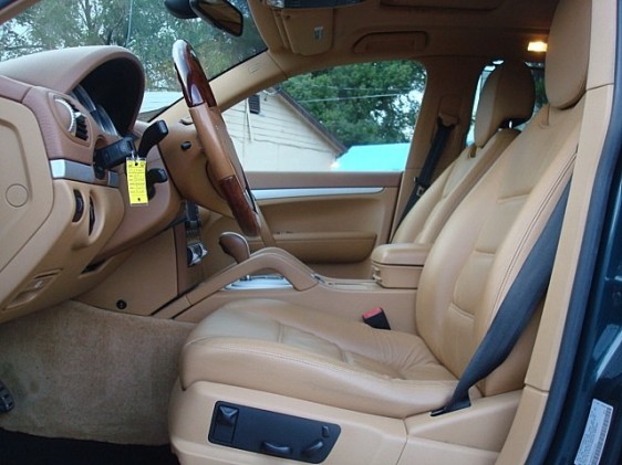

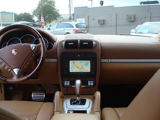

Boxster owner since '99 and just picked up this '04 Cayenne w\ 60k miles in minty condition. Still learning the car as it's a day old to me. I was not able to determine yet if the headlights are HID/xenon can you? They do move up and down when you first turn them on.
Does my iphone work through the bose audio? There is a male stereo type plug in the center console storage with a six inch wire leed?
I don't know all the options, but I will mention below what I do know and if anyone knows what automatically comes with certain options please let me know. I also included pics. I'm embarassed to say I don't know how to use the high low control, does it reset after the car is turned off or can I be driving around in its highest setting? It seems like it sits real high....?

Your car does not have PASM (air suspension) therefore the height is not adjustable. PASM equipped cars have more switches below the shifter. Non PASM cars have a nice coin tray I know because I have one of these coin tray too
I have HID and the lights do move up & down when you first turn it on. But I do not know if the non HID units move or not. What about the color of the light? Is it slightly yellowish (halogen) or bluish (HID)? Or does it take 1-2 seconds to warm up when you first turn them on that day? If so, they are HID.

thank you, then what is the rocker toggle switch....
that shows a pick of a highway etc on the console next to the tray?

The HID lights are the only ones to use auto leveling which is why they move up and down when you first turn them on. Normal halogens do not do that so you have the HID/Xenon lights.
As for the console switch, that is for controlling your all wheel drive system since the Cayenne uses a two speed transfer case for bad road conditions. I highly recommend you go to the Porsche dealer and order a manual (about $20) as there are alot of electronics and controls in the Cayenne to get used to.

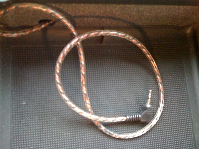

[quote=Pepper;2652403]Does my iphone work through the bose audio? There is a male stereo type plug in the center console storage with a six inch wire leed?
I don't think this is OEM, do you have any pics to show this?

[quote=Road Runner;2653901]
Very nice vehicle, congratulations on your purchase!
Here's the picName:  plug.jpg

[quote=Pepper;2656439]
Originally Posted by Road Runner
Here's the picAttachment 112085
It is definitely an aftermarket AUX input cable.
