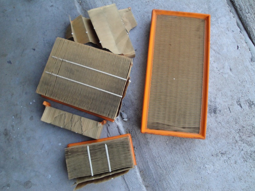

Hey guys, I recently did an air filter change on my 2005 Cayenne Turbo, here's a link to the process in case you guys are interested.
http://www.renntech.org/forums/index...filter-change/
I didn't take that long, but I did go crazy for a little bit when I couldn't get the passenger side air filter out...

Wow... those filters were DIRTY!

Yeah, I just bought the CTT and decided to do the regular maintenance. Good thing because the air filters were pretty dirty... I also changed the ignition coils and the spark plugs. I read in here that a common problem is that the ignition coils tend to crack, and after my check engine light came on (misfiring in cyl 4), I decided to change all 8 coils. All my coils where cracked, so thanks guys for the advice. Next in the list is to change the coolant lines to aluminum, hopefully they don't give out before I change them...
