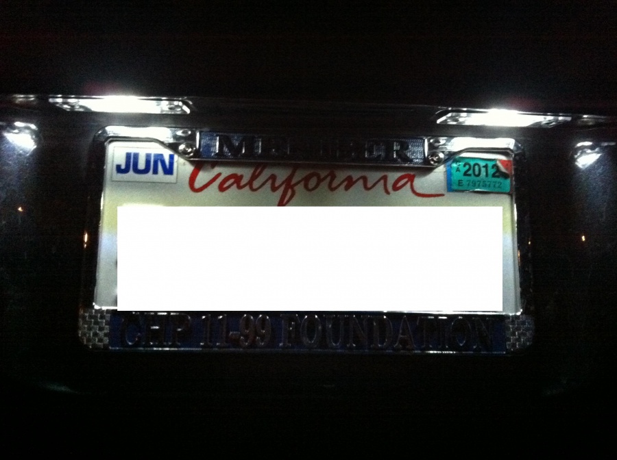

I installed the 37mm Festoon LED lights, and it was a perfect fit! Took 5 minutes to swap in these lights. It's so easy when you have the right size! All the vendors out there list 36mm as the size for the Cayenne, and I can tell you that doesn't work. 36mm is too short, and the light won't stay in the holder. You can buy any 37mm Festoon light. I got mine from Amazon.

Here's what it looks like.
