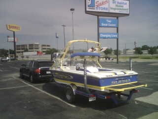

I regularly towed 20 foot Supra Launch with my base for 5 years.

Suspect you are towing total of about 4,500 lbs? The weight of our Supra Launch (great ski boat) is same as a 911 ~ 3,250 lbs? Your trailer 1,000 lbs? Boat wet with fuel and trailer 4,500 lbs?
If so, how is it on mountainous roads and braking? Any special equipment for the Cayenne? TIA.
