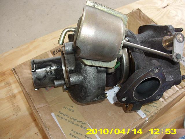

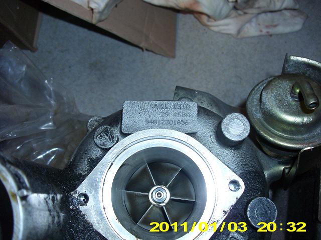

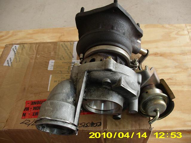

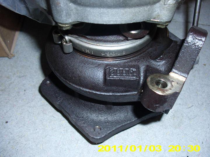

Can someone post pics and specs of the stock turbo?
I need some pics of the stock turbo of a Cayenne T.
Has anyone upgraded to larger compressor blades on a CTT?
Thanks.

Here you go...

Subscribing! What model is that? Part numbers? Specs?

here you go...cheers!
here's the website to confirm that its from a cayenne turbo....
http://en.turbolader.net/Turbocharge...bocharger.aspx
