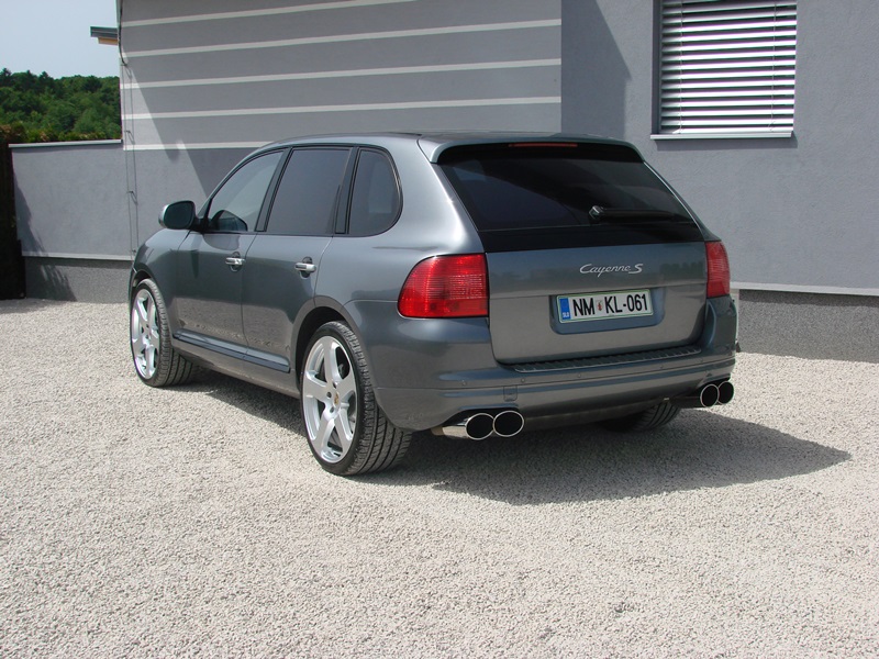

I have 22'' Rinspeed reps with 295/30 tires, with no issues at all, I actually didn't notice any difference over 21''.

Originally Posted by CALMOTION
Can you post pictures?
Here is mine...

gbratk
Thanks for the post. Did you lower the car? Love the way its sits without the big gap? You have air suspension on the S correct? Was the Rim and Tire purchase in Ebay. I think the 295 fills up the wheel well but doesn't the 30 profile makes it more vulnerable to bending/road noise?
Yes I have air suspension.
I lowered it with durametric. So now is LOW level like before LOADING level.
To be honest, I can here more road imperfection noises, but with stiffness I have no problems. I drive in comfort mode most of the time, and if drive in some really bad roads I also rise it to normal level.
However this is second summer season with 22'' and till now, none of them was damaged.
I bought wheels on eBay, and tires in local tire shop.
Dimensions of wheels is 10Jx22 ET50
Best regards
Gasper

Gasper,
What was the durametric setting was it 25 on all four corners per the guide? Would 295x35 rub insted of 295x30?
Thanks

To be honest, I don't remember how much I lowered it, but I know that I lowered it the same on all four corners.
I went with 295/30-22 because its diameter is closest to 295/35-21 (-0,6%). I could also chose 285/35-22, here is difference +2,5%.
But if you want to chose 295/35-22, there is difference for 3,4%
I don't know how much bigger diameter is acceptable, but like I said, I want to stay as close as it possible compared original diameter, so because of that I went with 295/30.
