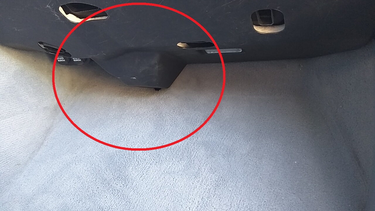

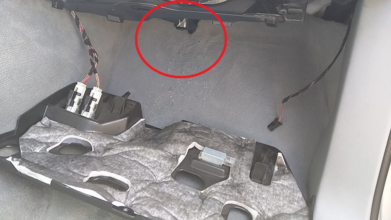

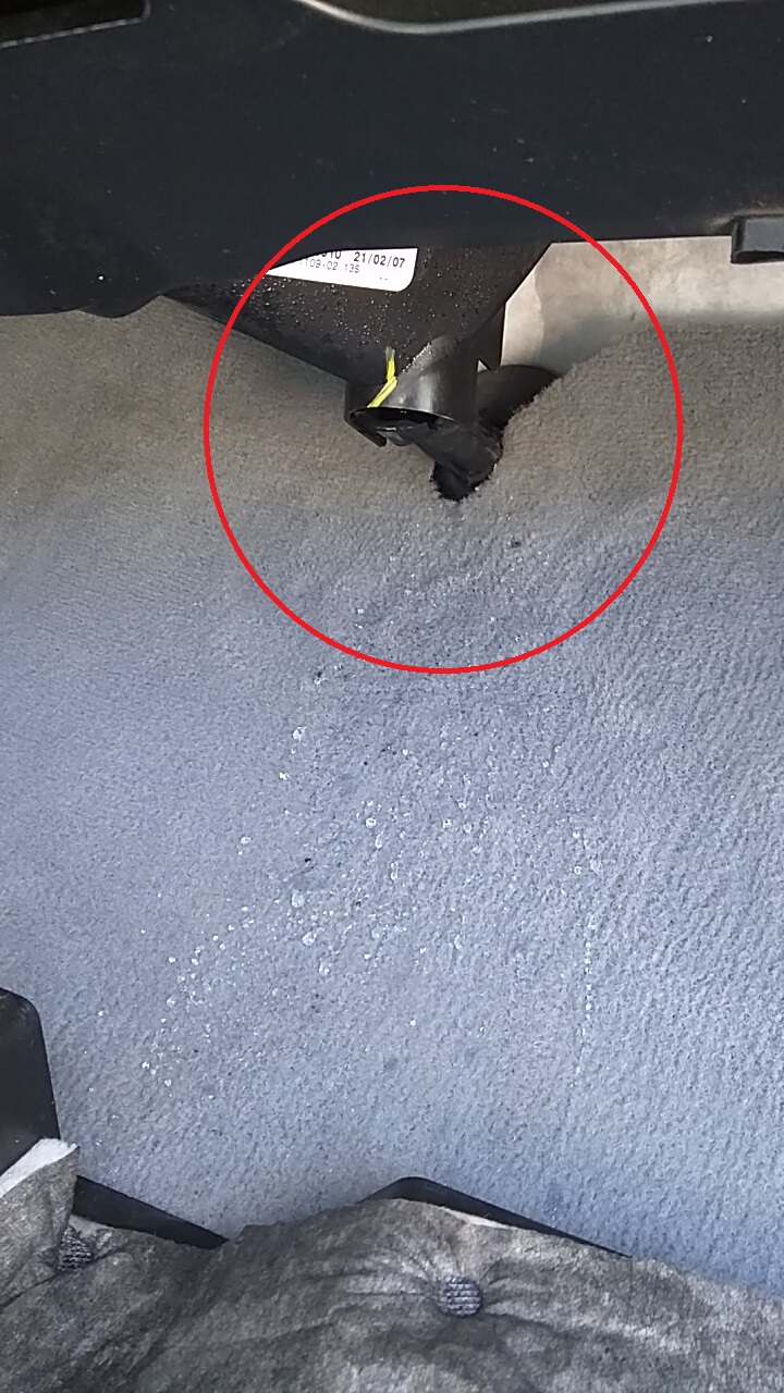

I had a similar problem.
Late last summer I would get in my car to find the windows fogged with a lot of moisture. I couldn't find the source. Then a couple months ago, my girlfriend was riding in the front passenger seat and told me that something wet dripped on her foot. Again, could find nothing. Then a couple weeks ago, something dripped on my foot as I was driving.
I presumed I'd had AC condensate drains backing up but never heard any liquid sloshing around.
However, yesterday as I was reaching backward from the driver seat to put something onto rear passenger seat, large wet streaks running front to back on rear passenger floor mat caught my eye. I felt the mat with my hand and it was indeed rather wet. I then looked at the floor mat at front passenger and saw similar but larger water streaks running front to back. When I pressed on the floor mat and carpet at front passenger, I was surprised to find it very wet and squishy with cool water. So when I got home I vacuumed it all out with my shop vac and then today I took a closer look.
What I found for my problem is this:
The condensate drain resides under the glove box area and the downward oriented condensate drain tube makes a 90 degree turn toward the front of the vehicle there in the front of the foot well. This drain is located about center (left to right) and so just look for the hump on the bottom panel that covers it. At this 90 degree turn is where the rubber drain tubing connects to the drain pipe and then the rubber tubing penetrates through the firewall.
To access and look, all I had to do was remove the single T20 screw that secures the black cover panel, then remove the panel. The insulation on the backside of the panel in the region of the drain connection was soaked also.
When I separated the tubing from the pipe end at the 90, about a cup of water gushed out. Therefore, it seemed obvious that somewhere downstream of this was restriction to drain flow. However, it seemed all that exists downstream is the continuing section of tubing. So I took a coat hanger, bent it straight, and poked it into the tube from inside of the cabin until I could hear it clinking against something in the engine well. There was no resistance to doing this which was a surprise to me since I anticipated some debris.
I also had the hood open and so took a look from the engine side and although it's difficult to see, I could see the section of coat hanger that passed through and traced it back to see what only seems to be some sort of rubber lip end of the tubing that penetrated to the engine side. When I removed the hanger and examined it, there was some sludge of sorts on it but that was all.
My guess is that the rubber outlet portion of the tube got gunked up and sealed itself with sludge.

Yep that's the condensate drain from the AC evaporator. If there was sludge on the coat hanger it could just mean you poked a little hole through it. I'd suggest getting a small bottle brush or something and seeing if you can clean it out better. Like someone mentioned in previous post if you aren't seeing a pretty good size puddle of water just inboard of your passenger tire after driving for awhile then something is plugging it up or it's become disconnected.
