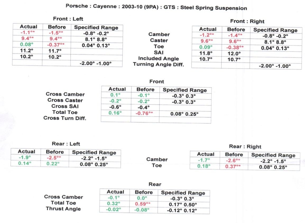

Also, does anyone have any alignment specs after lowering their Cayenne on coilovers?

For mine I used the Cayenne GTS (steel spring) alignment specs to the more aggressive end for camber. Seems to do well and I have over a year on my BC Coilovers with nice even tread wear.

Hi David,
I know this is an old post, but do you recall what the actual camber settings were on your car, and how was the tire wear after the changes?
Thanks in advance

Sorry, I haven't had the coilovers with springs for several years. I do know it was the factory spec for the 2010 Cayenne GTS with steel springs that I used and the tire wear was great with my Continental Extreme DWS tires.

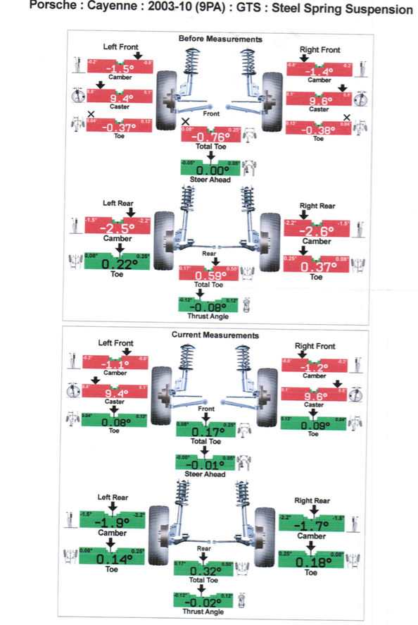

Hi David
Thanks very much for the reply. The setup you have now sounds like a very interesting option.
After an initial setup I have the rear camber within spec but it is proving difficult to get the front within spec as shown in the pics below.
If anyone has any comparisons/comments to share, that would be most appreciated.
