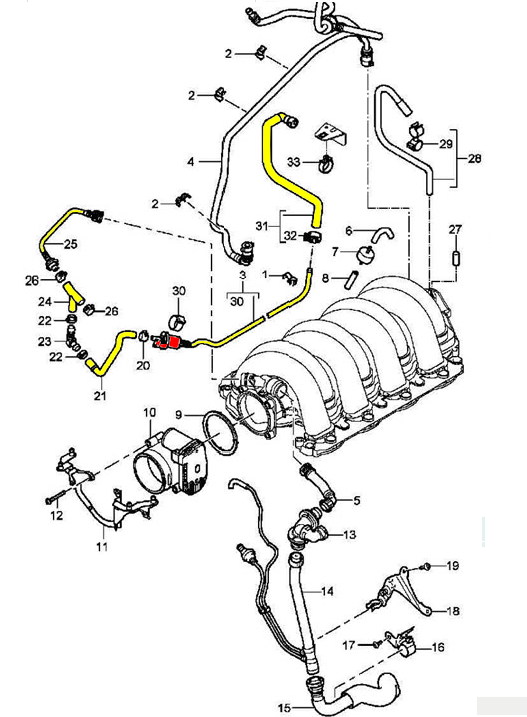

had the same problem, solved it yesterday.
first check on a scanner, it should be either ignition coil or it will read a p0441 code.(look for ignition related codes)
if it does, it means there is a leak in your vacuum system. first check if your fuel cap is ok, if it is, u will probably need to change the purge valve. its found on the left side of your engine. the part code is 948 110 202 01 its an easy DIY.i changed the coils, the valve and the fuel cap. the code is gone, the car is acting normal now, i cant believe i got of this annoying hesitation. let me know.below is a drawing. the valve is on red and it is attached to a thin tube.
