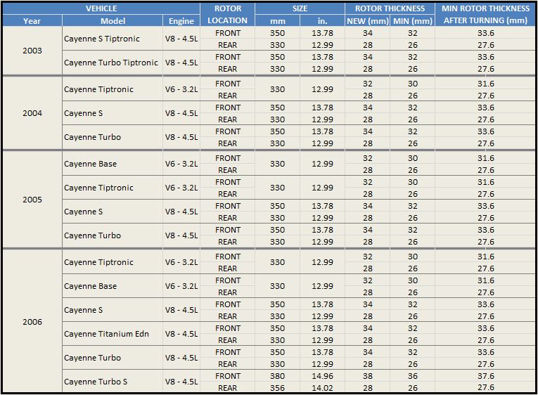

2003-2006 Cayenne Rotor Specs Information
I thought to pull this info from service manuals to help those new to the car. Maybe this will help get the info quicker.
If you notice a mistake then let me know to correct (but this info was from service manuals, so I hope that won't be the case).
Thanks.
