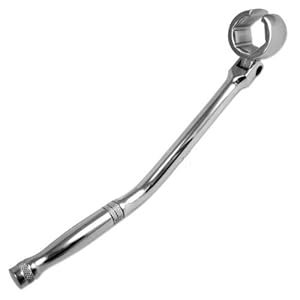

You have two sensors that could throw this code. One on each bank (engine side) before the secondary cats and after the primary cats on the primary downpipes. The are tucked up under the chassis next to the transmission bell housing. Replacing them is easy enough, just source a special tool called a "oxygen sensor" wrench (7/8" or 22mm) and apply a heaping amount of torque to loosening. I used a right angle oxygen sensor wrench like
this one this one
with good results:
Then follow the wiring up to the top side of the engine bank to the factory disconnect.
