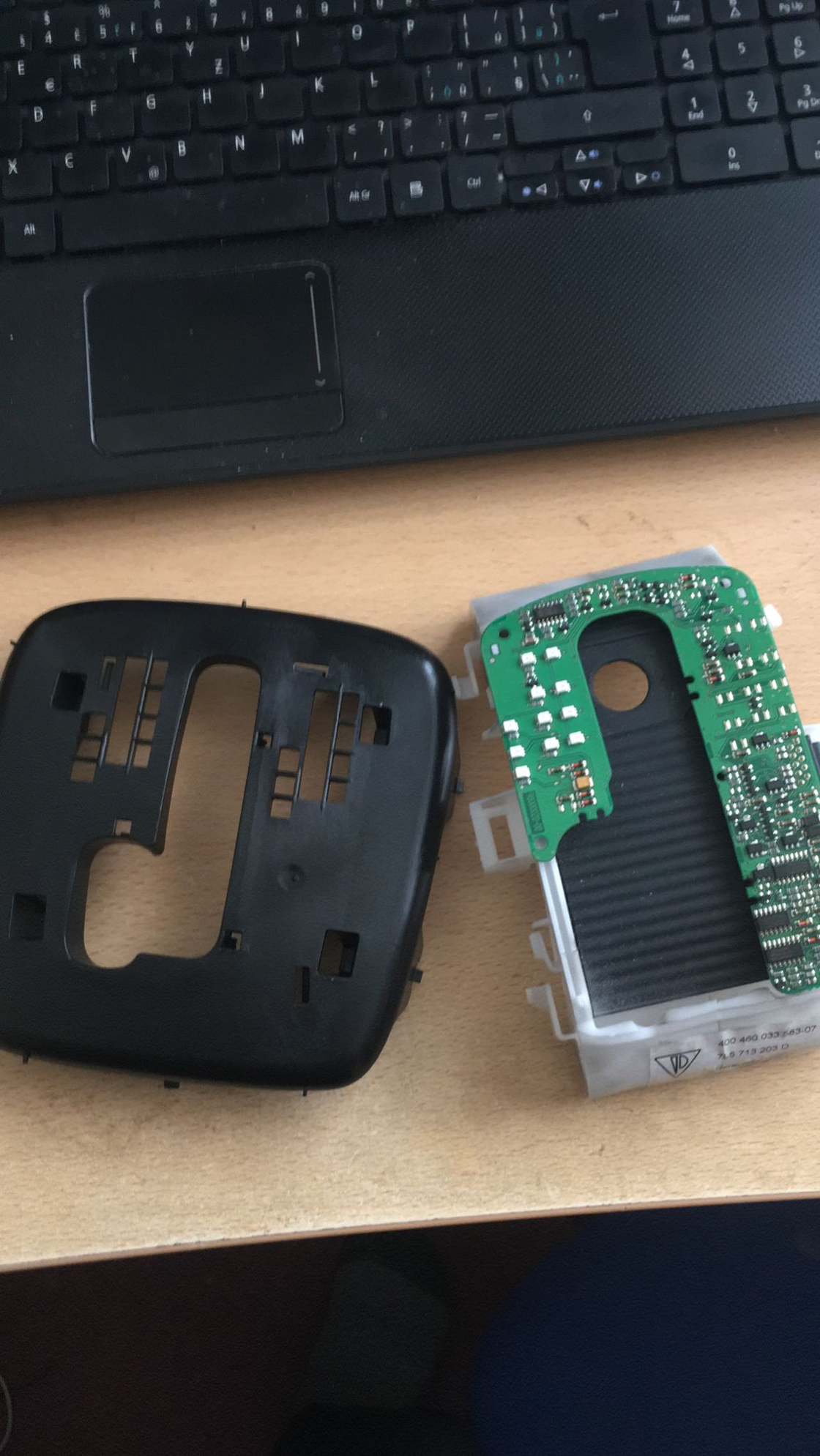

I fixed this issue on 957, problem was inside her lever panel, there are contacts which reads where is the lever, it’s similar to fuel lever sensor mechanism. Contacts can be dirty
