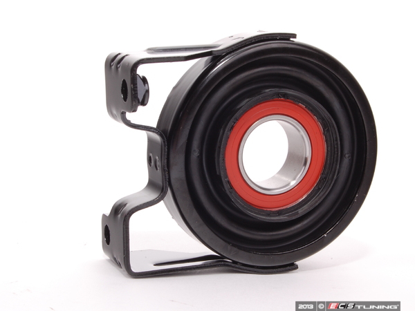

If your Cayenne is experiencing heavy driveline vibration or noise, the most likely cause is a worn or broken driveshaft center support bearing.
The Cayenne has a two-piece driveshaft, linked in the middle with a flexible coupling, supported at its center by a rubber-mounted bearing. Wear at the bearing or its mount will leave the shaft with no visible means of support, causing vibration and thumping that only worsen with neglect. Installing a new support bearing is a cost-effective cure that's sure to restore order South of the floorboards.

If thumping under your center console while turning corners or accelerating, it's likely the center support bearing in your cardan shaft has failed. So don't delay and order yours today.

This $45 part does the same job as the $389 part from EPS (or Vertex if you look on the forum about 6 threads down)?

The Vertex bushing is great, but if you experience failure of the actual bearing (which can be caused by bushing failure), it won't help, since it uses your original bearing. The catch with this bearing is that it takes a little more effort to install. To replace this bearing the driveshaft must be removed and separated. To some, it's worth the savings, to some it's more worth it to just replace the whole shaft.

It should also be noted that the Vertex part is $429 vs a rebuilt driveshaft from Colorado driveshaft at $375.
