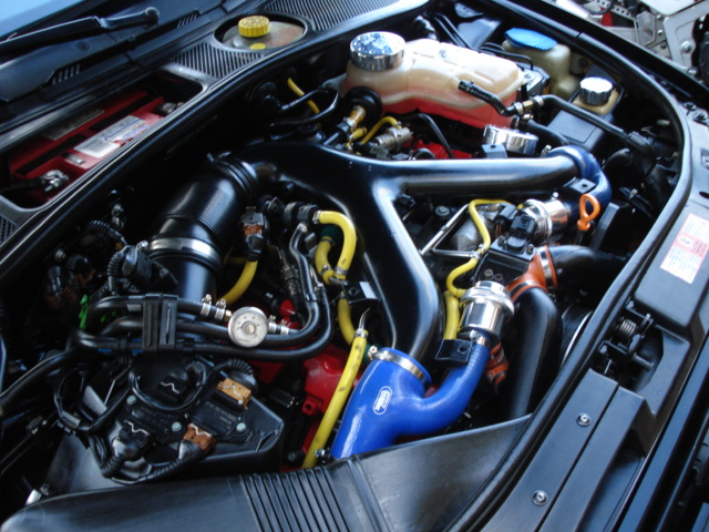

(no pictures of the CTT, so here is the Audi)
My 2000 Audi S4 with 168K miles on it.
