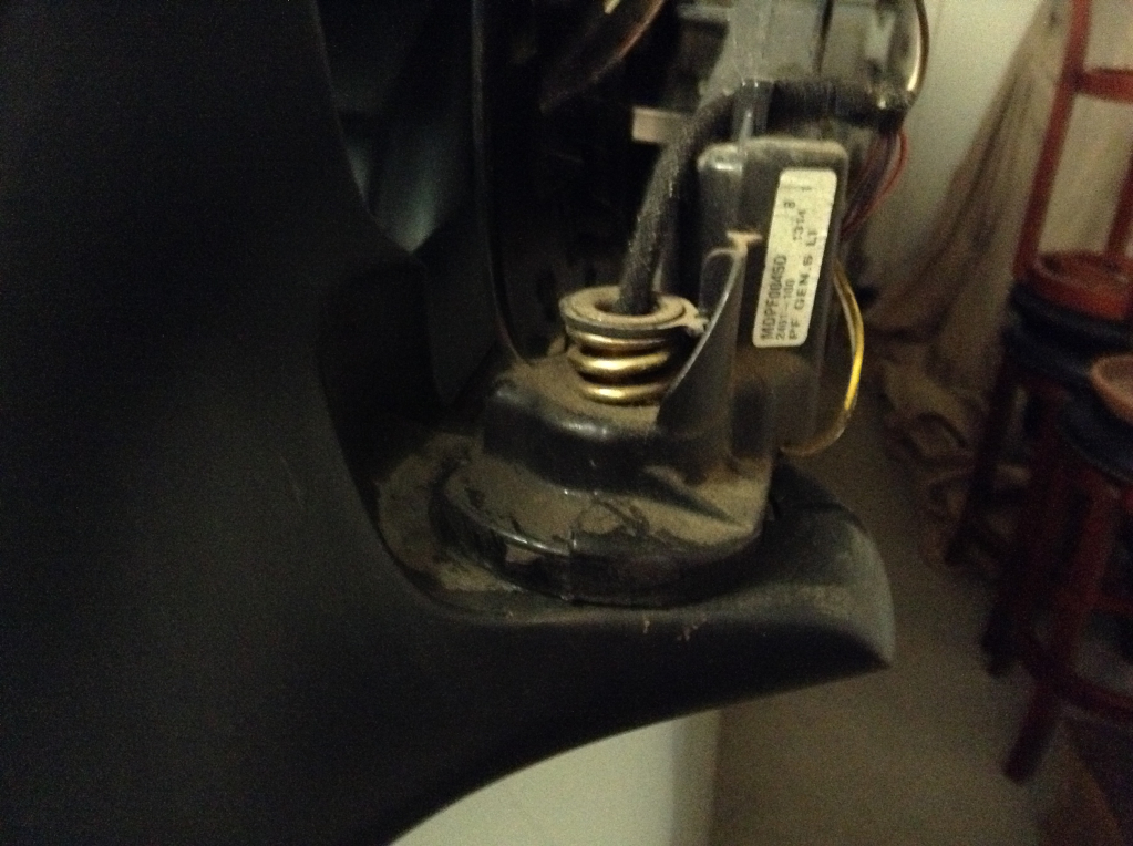

[/HTML]
Originally Posted by aspenone
That is a good idea man I would check out the spring
Yeah I can't tell if its compressed correctly. Here is the thread I found on the passat ( I know it's not porsche but looked similar setup:
http://www.passatworld.com/forums/61...ired-pics.html
And here is mine
I should mention I don't see the clip the passat thread mentions.

By comparison the one you showed me although not sure if its a different angle looks a bit more compressed then yours. I assume there has to be a special tool to compress the that spring, only way I can think is a nice set of needle nose pliers or vise grips and wind the coil. Maybe there is a position where it locks back into place. You said the other one is doing the same, I think they are only synced by electronics not sure why the other would be the same way
I think I'm going to take mirror off so I can look inside the housing. Going to be a pita though cause door card has to come off.
