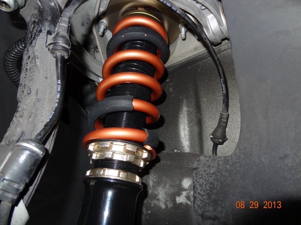

Porsche Porsche Cayenne S 2008 - BC Coilover / Swift Springs
front shock 8 threads to the lowest setting
Also the 4 upper mount nuts 13mm to the chassi suck and are a long hard turn with 3/8 rachet 2 entensions and a universal knuckle to access the angle...dont loose these hand turn the off the last threads so you dont drop them ...if so use the flashlight app on your phone to find them

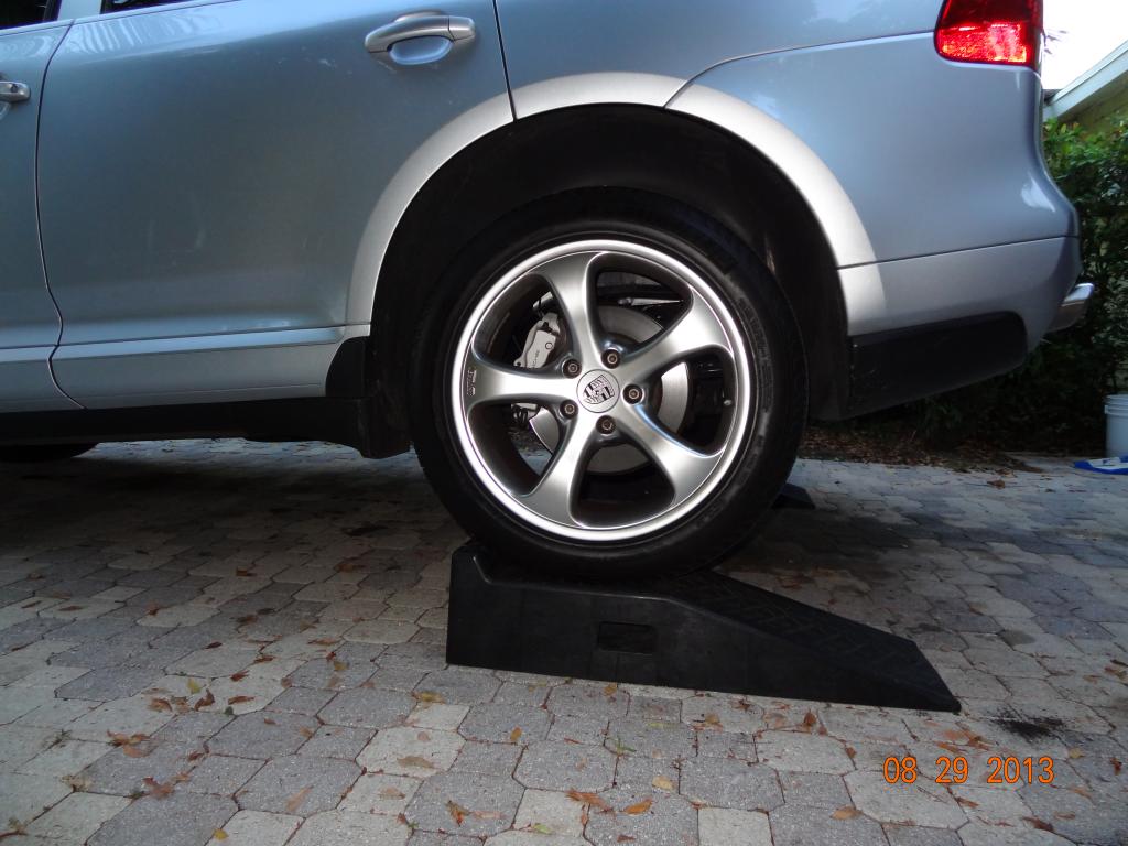

Ramps great for rear end access for adjustments and initial jack heights to get jack stands in place. notice I have them reversed in order to allow more jacking with the OEM Porsche jack with 2 layers of 2x10 wood blocks to raise the jack up to the increased height. Always have other stands and back up jack PLEASE!!!
If you dont have all the Jacks Rent them !
Call a Buddy and loan a Jack
NOBODY WANTS YOU TO BE UNSAFE UNDER A 5500LB VEHICLE!!!
ALSO IDENTIFY A SOLID CONCRETE BASE ADD WOOD TO SPREAD THE WEIGHT ON THE GROUND. USE WHEEL CHOCKS, FOOT BRAKE, CAR IN PARK...ETC...BE SAFE
WARNING BE PREPARED TO LOSE A FEW POUNDS OF WEIGHT WORKING HARD...LOL!
ALSO IDENTIFY A SOLID CONCRETE BASE ADD WOOD TO SPREAD THE WEIGHT ON THE GROUND. USE WHEEL CHOCKS, FOOT BRAKE, CAR IN PARK...ETC...BE SAFEWARNING BE PREPARED TO LOSE A FEW POUNDS OF WEIGHT WORKING HARD...LOL!

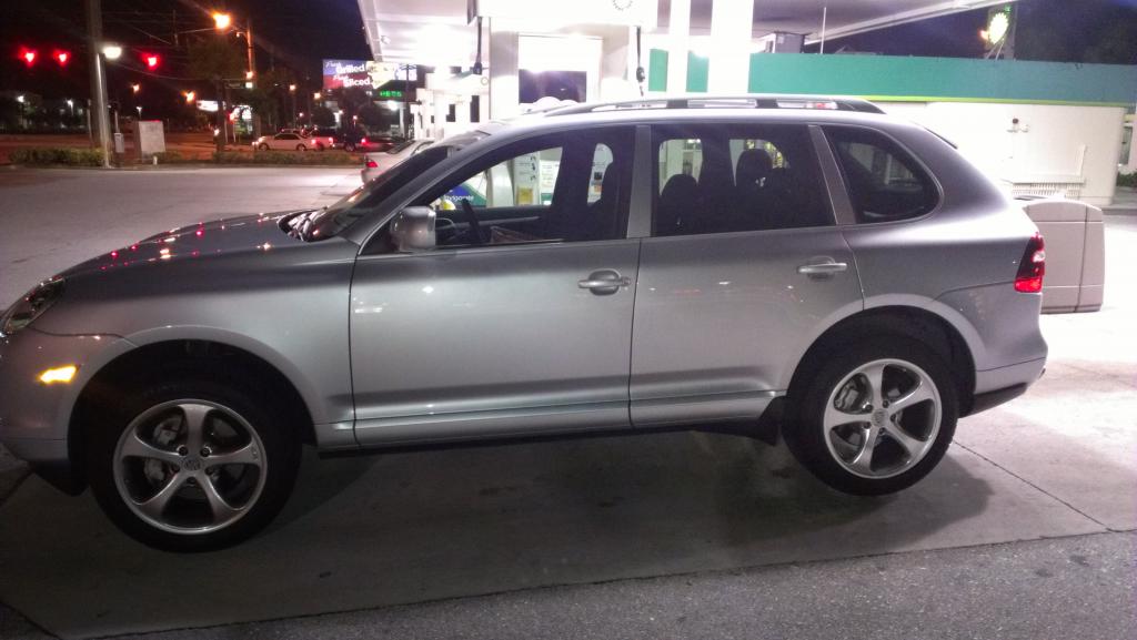

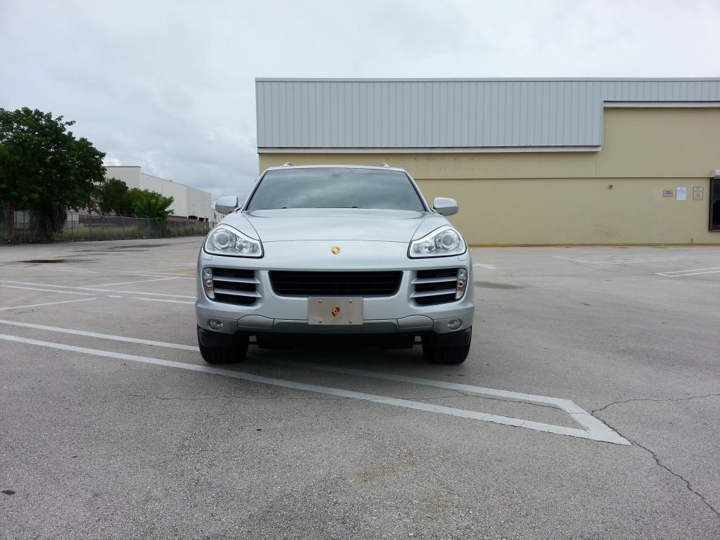

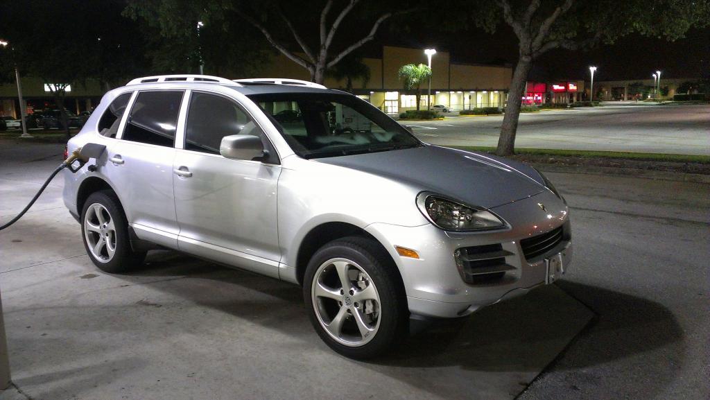

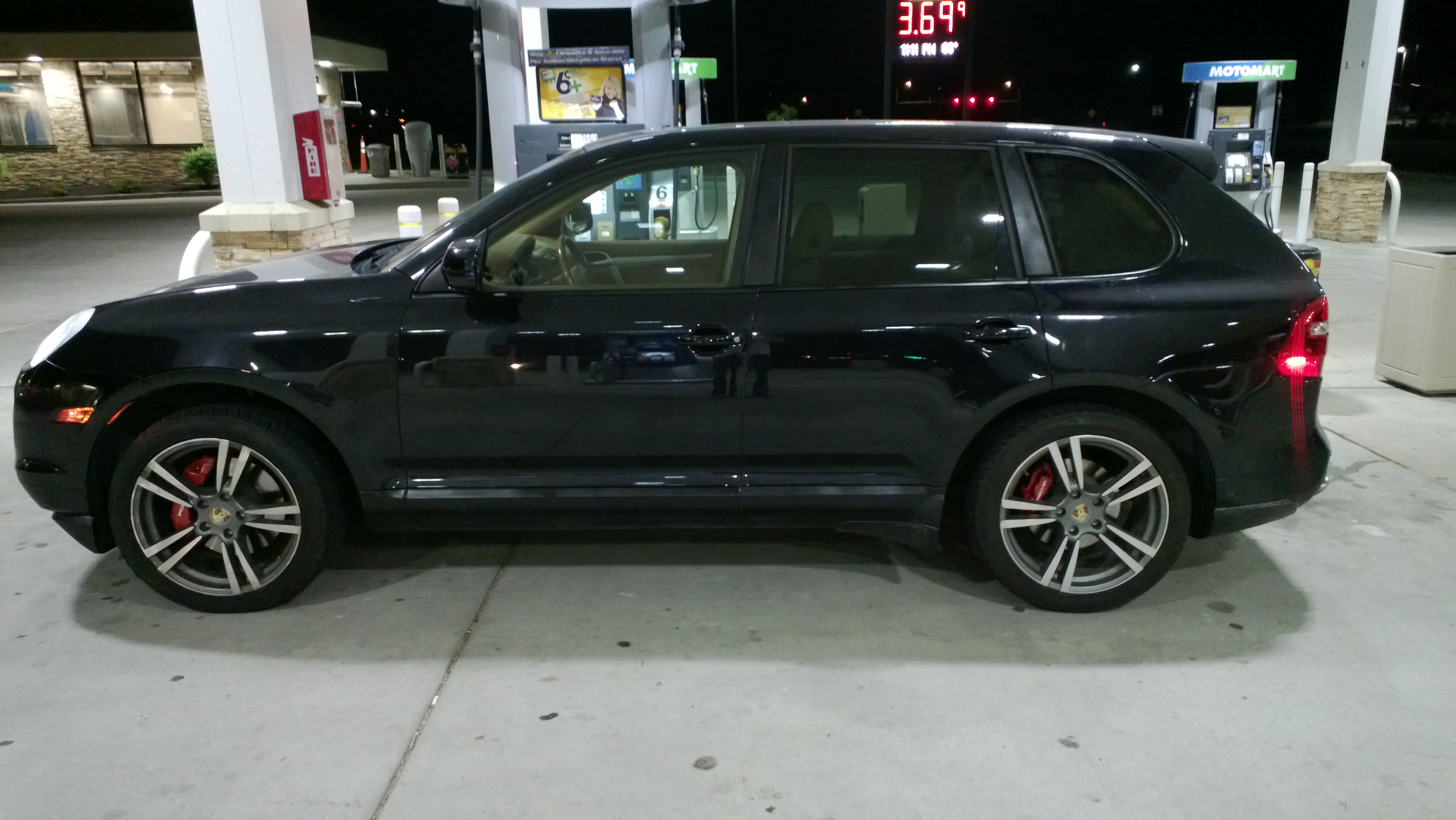

Before...
After
Here is the end look...I can go lower & did but the rear end looks like its dragging on the ground, here I have enough clearance underneath for bump stops etc and not too much air under the chassi at high speed. When its too low it does not look right. Also at -.05 Negative Camber I am just 'out' of OEM spec range max of -0.35
Front
After
Front
I Agree, I was contenplating a bigger floor jack...the little Sears floor jack was a strong item, and the jack stands speak for safety
However its now a done job, along with Cat Bypass install ...(NB: before the CS was lowered, it is good advise to do your exhaust work first for workable clearance underneath)
My next improvement is the Air intake and ECU Chip...then and I am done...after all its a SUV and any more modifications than this is turning silly, if i need more... I just grab the M3 keys instead
I will say it get good and negative looks from 'other' SUV owners who try and contend...only to hear the sound of V8 Porsche with the lowered stance and soon back off...

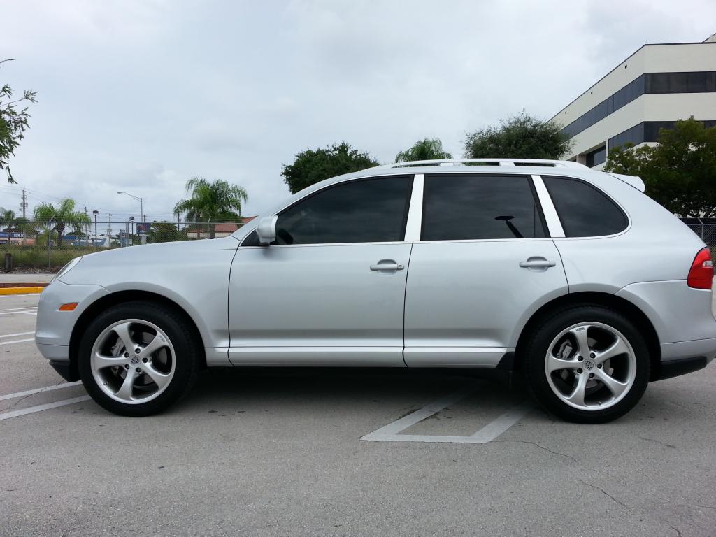

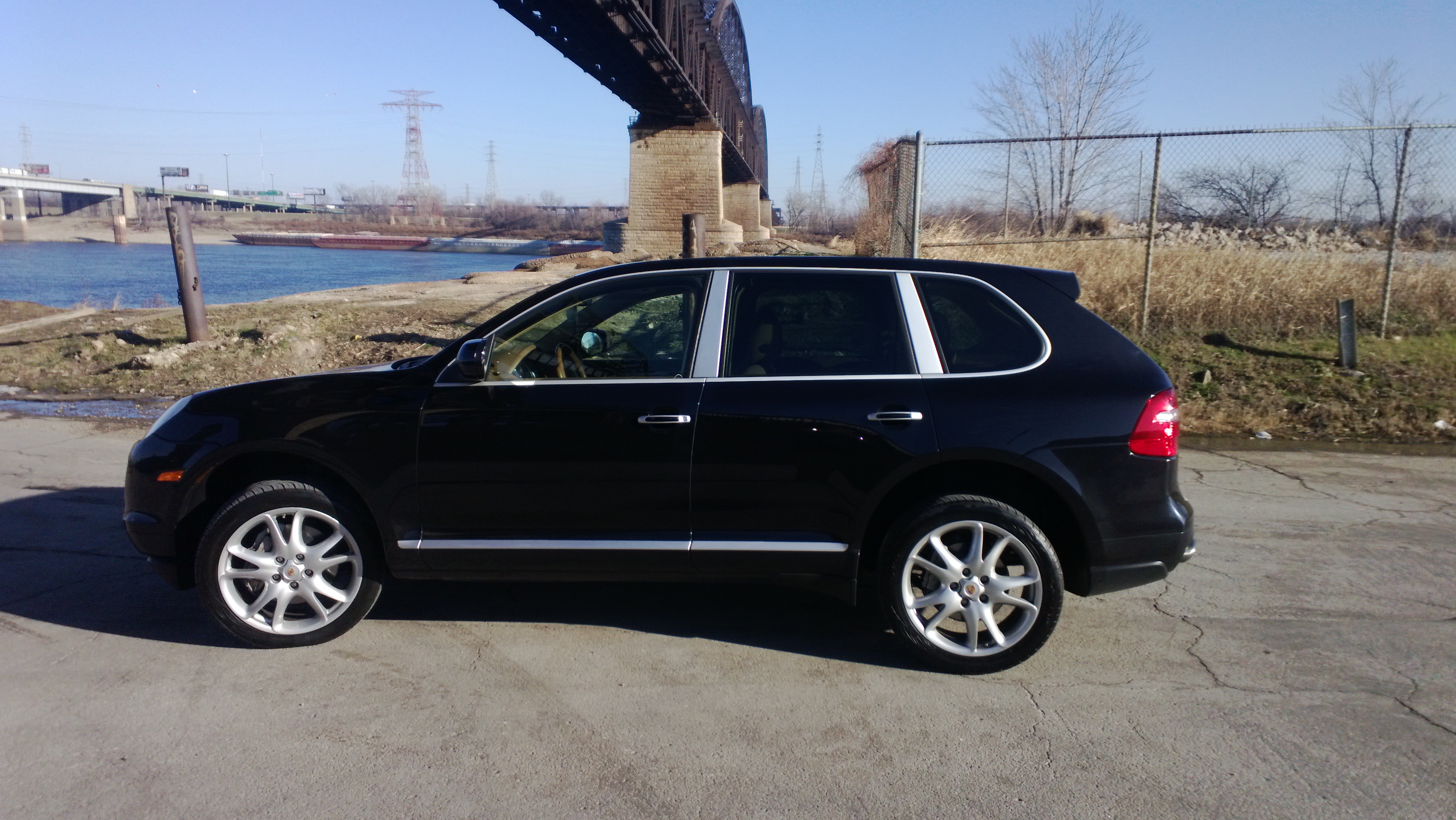

Looks like you need to raise the rear shock 2-3 turns, it looks a tad lower than the front. or down 1 front up 2-3 rear.
When I am in the vehicle I look at the passenger door panel as it meets the window for rake level...I should have put a builders level on it to be exact, but eyeballing it is good. You sure get a feel for minor changes in ride height to a 1/4 inch
Some say the rear should be higher than the front to give the vehicle some rake, as well as allow the additional weight of passengers in the rear...not to mention towing.
I measured the rear on mine 1/2 higher than the front. measuring the wheel arch to the top of the rim was more exact that the wheel arch to tire.
This 1/2 more in the rear actually gave the same negative camber result front and rear after alignment. So I guess this is a good
P.S Nice Wheels!... can you tell me about them?

My lowered settings were front... (length of strut)
11 1/4 inches from top of strut, to top of lower adjustment ring - with 8 threads of shock body between lower and upper adjustment rings. I have approx 6 mill pre-load front, 5 mill rear. Pre-load and ride height settings were finally adjusted after two weeks 100 miles driving.
Rear: 52 threads between the two adjustment rings I used a drawing pencil with a fine lead tip to count the threads, or a fine point instrument will work well
These adjustments are 'Bang On' for a lowered ride but not too low, or the *** will look getto...I also took in mind that too low will void any possible alignment away from too negative camber. also rear is approx 1/2 inch higher than the front for some rake/passengers and a reasonable tow hitch height
