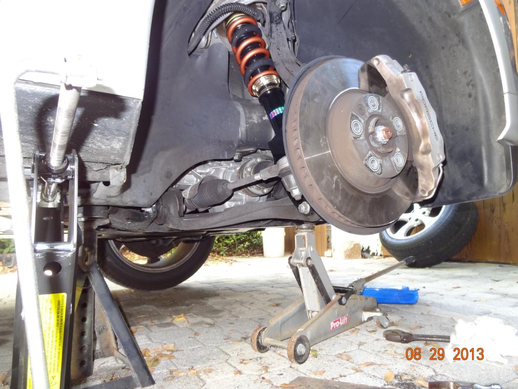

Front strut my lowered setting is 11 1/4 inches from top of BC coilover mount plate to top of lower adjustment ring. Also there is 8 threads on the shock body between rings. I feel this is probably the 'near lowest' setting to get -.05 deg negative camber.
Handy trick to hold up the spacers (needed for Cayenne as the bolts do not have enough thread tapped from factory to tighten the plate up to the chassi)
I used Cat5 cable wire wrapped twice...as they will fall down and roll away!.
Also I market the top of the shock mount plate which way was hard or soft with a sharpie marker pen, so I can get my fingers in there to adjust again without full removal...just the upper bolts backed off will allow enough room to get the dampening settings access. Rear...SORRY full removal required...

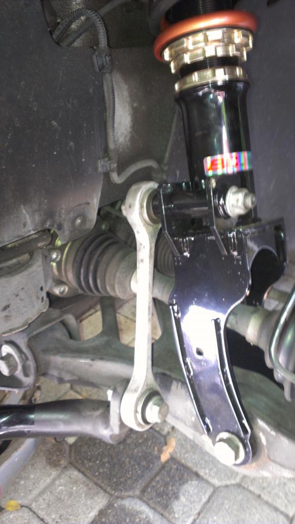

Make Sure you undo the lower sway link first to take tension of the other bolts...leave it off and install the other side the finally come back to it to re-tension the sway's. This is your first step
Porsche bolts are slightly tapered to the head so robots can mount on them fast...in other words they are cast crap that will not hold worn tools...get new or decent sockets that match the bold head octagon shape, also a ring spanner is key.
I would advise some light gloves to save some knuckles if you get a tool slip...the scar and black fingernails don't look good at dinner! YOU NEED GLOVES on porsche bolts!!!!

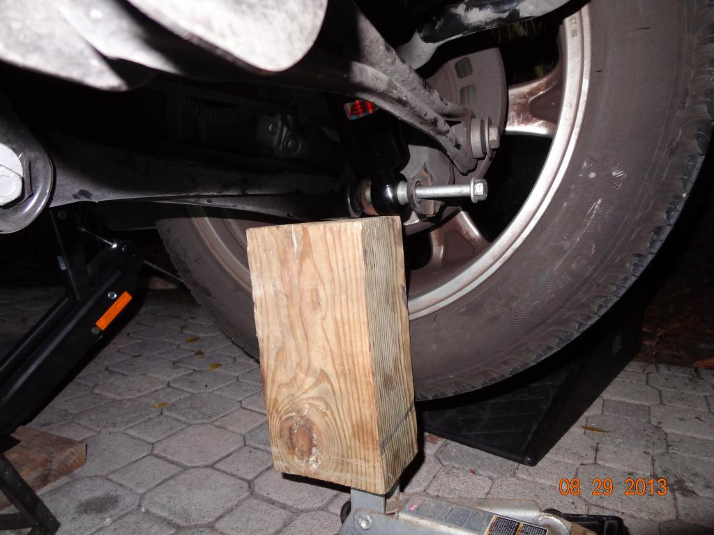

Remember when you are working without a full lift and using jack always put chocks in the wheels (brick), brakes on, large wood pad under the CS jack (2x10 wood) to spread the weight on the small ground plate.
Also beware the Porsche jack fully extended it becomes wobbly and my lean/fall get more blocks of wood under it rather than extend fully PLEASE! Also use jack stands / back up jack NEVER ATTEMPT THIS WITH ONE JACK ONLY. RAMPS HELP TOO
