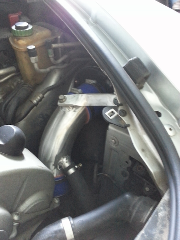

I swapped out the original filter for a new pair of k&n filter. I discover that the small piping that was link to the airbox cover on the right hand side is broken. A reason and excuse to replace the stock air intake with some nice set of aluminium pipings and k&n pod filters. Getting closer to my goal step by step only if the turbos would be easier to remove without having to completely removing the engine would be nice.

Still waiting on appointment to get the exhaust tips done. So on goes the intakes.
