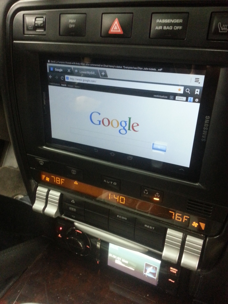

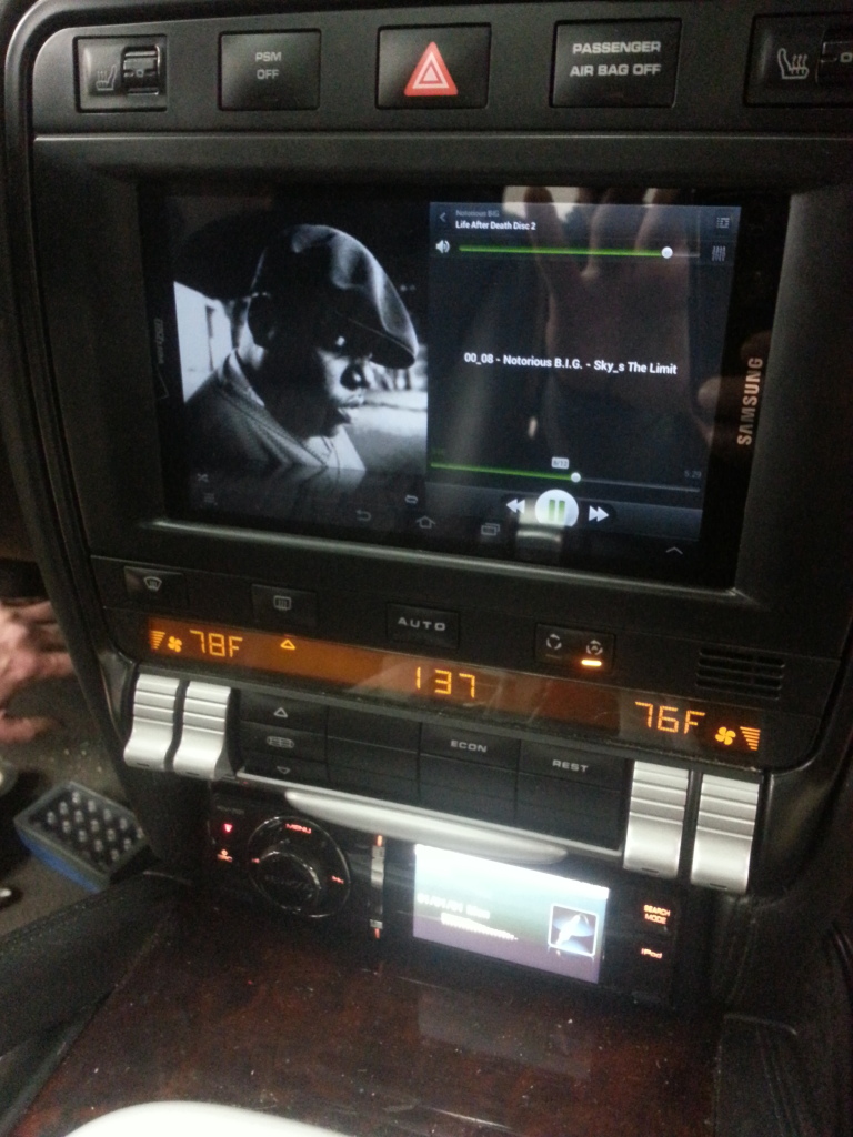

It's still at the stereo shop getting the custom fiberglass speakerbox built which will be down in the wheel well... when I get it back next week Ill do a video review.
We removed the ashtray, and widened the gap, to fit a cd player, which functions as the main HUB for the stereo, everything feeds through the cd player. Sirius radio, back up camera, iPod, Tablet Audio, Hands Free, steering wheel controls.... everything works and sounds GREAT!
ID:	304740   Click image for larger version
