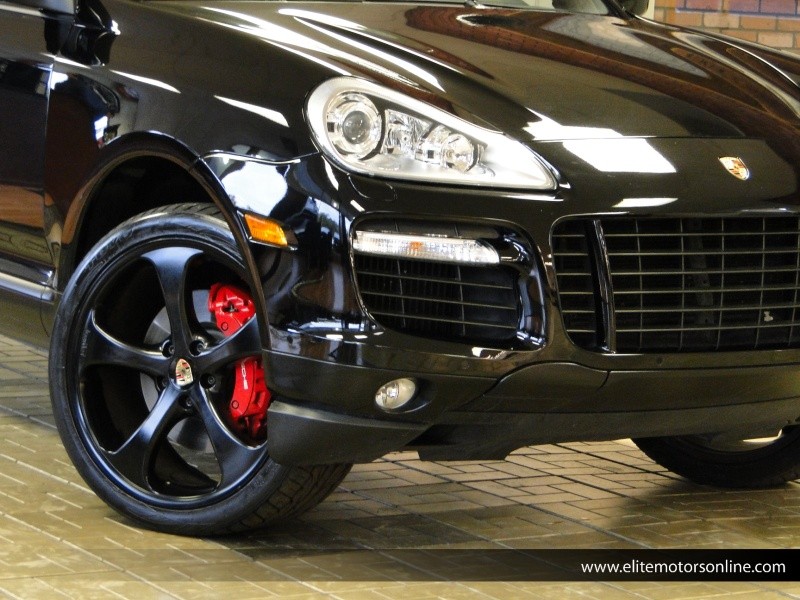

Hey folks,
On my 08 Cayenne Turbo, my front turn signals are below my headlights. They are in the turn signal assembly light (has the white LED solid bar that comes on with my parklights) and are NOT in the headlight assembly. Is there a trick on getting to the bulbs? I hope I don't have to take the bumper off. The only other way I MIGHT be able to access is through the wheel well. Any other ideas or is there a simple way to access the bulbs. Thanks again. Attached is a picture of my front end. As you can see, the bulbs are in that white LED strip below my headlights.

Did the bulb blow out or something? Im pretty sure these are a LED strip almost like a halogen bulb. I dont think you have to take bumper off I would take the understray cover off and the fender liner to gain access. The best is to put the vehicle up on a jack stand, take off the wheel and remove the fender cover this will give you the best access to the light.

If you have a turbo, pulling the fender liner won't get you there as the intercooler is in the way. I believe these are LED and you'll likely need to replace the light assembly. That means removing the bumper cover to get to the fasteners.
+1 on this,I was looking at my bumper yesterday and just realized this for the turbo models, but if you have a non turbo I beleive you can get to them this way.
