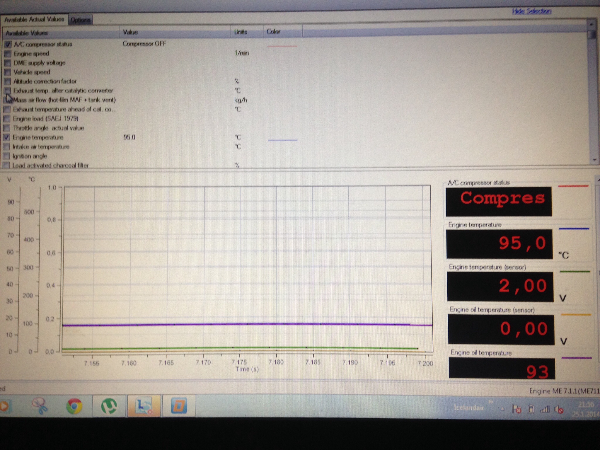

Hi guys. Sorry about me bringing this topic up once more but I have been trying to get to the bottom of this and all the discussion that I have read does not lead me to the place I want to go.
So what I am experiencing is that my CS is running hotter then Im comfortable with. I have been seeing the coolant temp go up to the 3/4 marker aprox 100C (215F) then as soon as the fans go on it drops down to 80C (180F) this continues to go on in stop and go traffic and even if the car is traveling slow <40 kmh (25mph)
I have tried the AC compressor trick and that does not work for me.
The oil temp is rock solid @ 85-90C (aprox200F)
Sometimes I smell traces of coolant from the AC but this happens randomly.
My climate is rather cold winter average around 0C (32F) and summer time it hits 15-17C (59-64F)
I also have the durametric ( not knowing fully how to best utilize that tool)
I have included the pictures I tookmfrom the live data
Any suggestions about how to solve this issue is appreciated and many thanks in advance guys.

I think the radiator fan is working properly. At least when looking at the live data from
durametric it shows me when engine temp reaches 95-97 (215-220F) then it rapidly decreases to around 82 (180F) when the fans kick in.
(I thought that it was possible to test the component with durametric but have not been able to locate that option)

THANKS DLF for the answer.
I have not seen a leakage from the cooling system at least to my best of knowledge.
There are no error codes that I can pick up with Durametric for the cooling system...does any one know if there is a way to check the fan module with durametric or somehow to determine if its the fan that is causing this ?
When I got the car it had already been upgraded to aluminum coolant pipes but I dont know if the thermostat was replaced at the time.
The waterpump is original as well i think.
SO all durametric experts please let me know if there are some ways to do these testings with the durametric.
