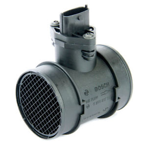

Also, once you get it removed, you will notice that the MAF is installed with security 5-point torx like screws. If you do not have it already, you will need to get this tool.

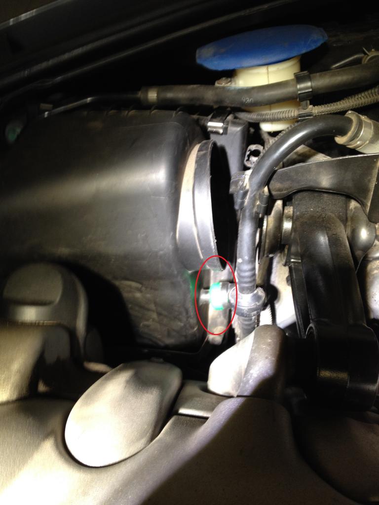

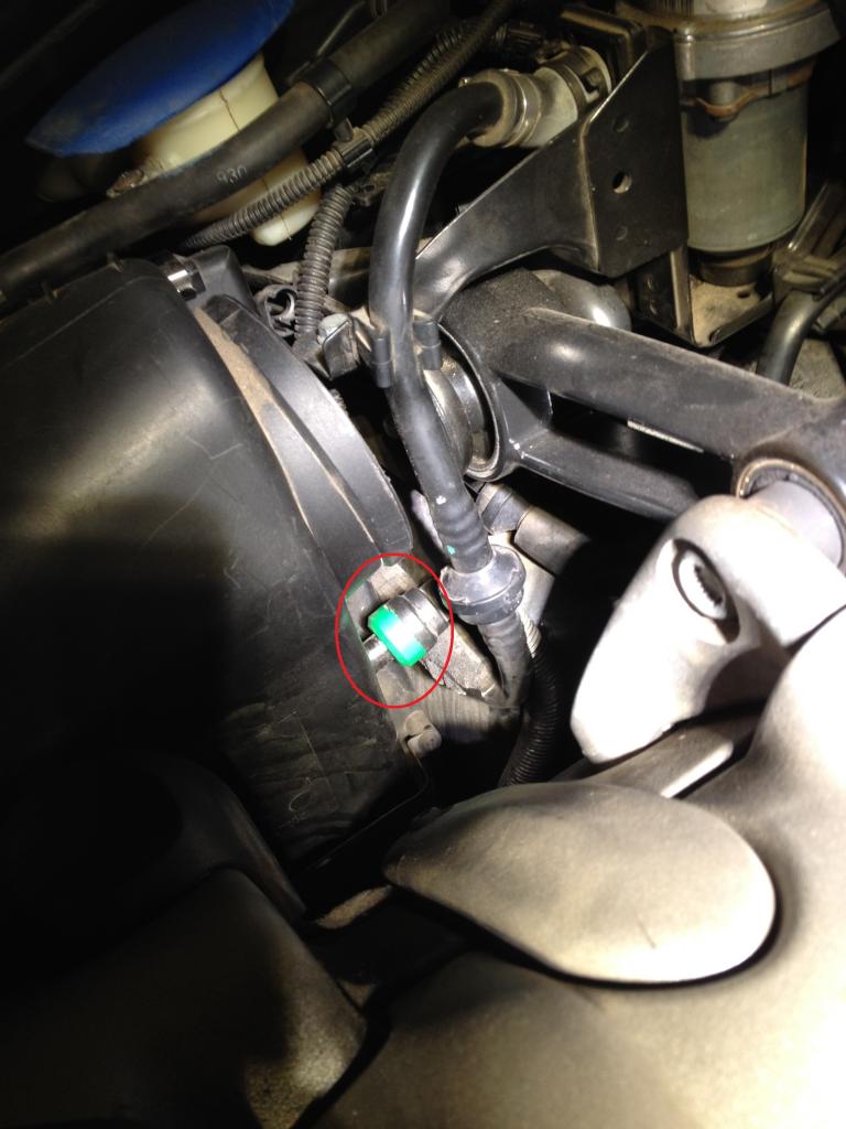

Guys, does anyone know how to take off the connection point that's circled in red on the US passenger side of the engine intake air box? I tried pulling on it and no luck. Do I just pry harder or is there a way to take it off without breaking it?
Also, what is it? Is it an air intake temperature sensor? When I look behind the air box it looks blank...any advice would be greatly appreciated. Thanks!

thats the hose that connects to your air compressor...what brand intake are you installing? In order to take that off use a flat head screw driver..you will notice a groove on one side stick the flat in there and turn to separate the two its basically a clip that holds the hose.

Okay so I got the green ring cap snapped off. Now how the heck do I pry the connection apart?

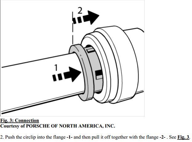

Once the green cap is off, you press in the release collar (towards the hose) then pull hose off. The release collar is under the plastic cap.

Thank you for the tip. Did another attempt this evening and failed once again......just that damn connection point separating me from my new air intakes...

Here is a picture:

Success THANK YOU. I can definitely hear the turbos spooling now. Just getting used to it. Can't tell a power difference though...not even butt dyno difference. What kind of additional power are cone filters supposed to provide?
