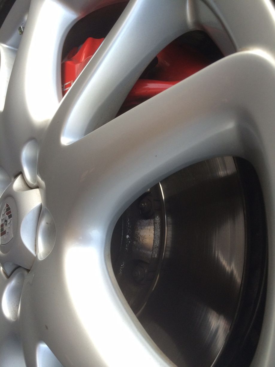

Here is a picture of my front rotor. I am being told that these are upgraded brakes with a two-piece rotor for which there are no aftermarket replacements. Is this true?

I had the car since new and no aftermarket work was done on it. I'm told that the hat (?) screwed onto the rotor (in the pic) is what makes this rotor 'different' than others. These also look somewhat like 380mm CTTS rotors.

Those are two piece rotors as opposed to standard single piece. My 955 CTTS also has two piece 380mm rotors and they are ridiculously expensive when compared to the one piece option. I'm not very familiar with the 957 so I can't say if it was an option. This is really interesting since you've owned it since new. I wonder if the 957 came with an e81 package as offered on the 955s? But, then again, it looks like people have searched your VIN...confusing.

VIN WP1AC29P69LA83354
Front rotor left part # 95535140161
Front rotor right part # 95535140261
Rear rotors left and right part # 95535240300
Your dealer is correct, they are the Turbo S variety.

Those are the same rotors I have on my CTTS and they are the upgraded brakes...the price for them is crazy check out suncoast porsche they sell them at what Ive been told is wholesale
