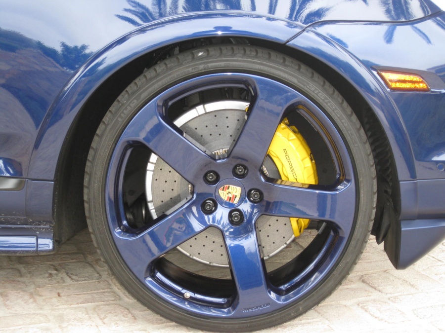

yes, the same. only upgrade is ceramics. you can buy ceramic kit from new cayenne, and only issue will be remachining rear calipers and make adapters to them. porsche number 95804460500

Is that the front or rear ceramic brake on the cayenne in the picture? I see there is 315/25 tire on that wheel. Do you know what the offset of the wheel is?
For my brakes, I guess I will stick with the stock calipers and stock size and only upgrade the rotors with cross drilled ones and pads with more aggressive ones.
Do you have any info or experience on which pad gives good fade resistance, more stopping power and less brake dust?
of course it is front )))
r22 have et50. on photo r23, et don't remember, maybe later
my friend with 405 brembo uses ferodo 2500 racing. he uses 380 brembo at rear
315's in the front? Hell, yeah. )) You got to learn me the width and offset of that wheel? There is no way ET 50 will work in the front. Maybe they are ET 40 or lower.
