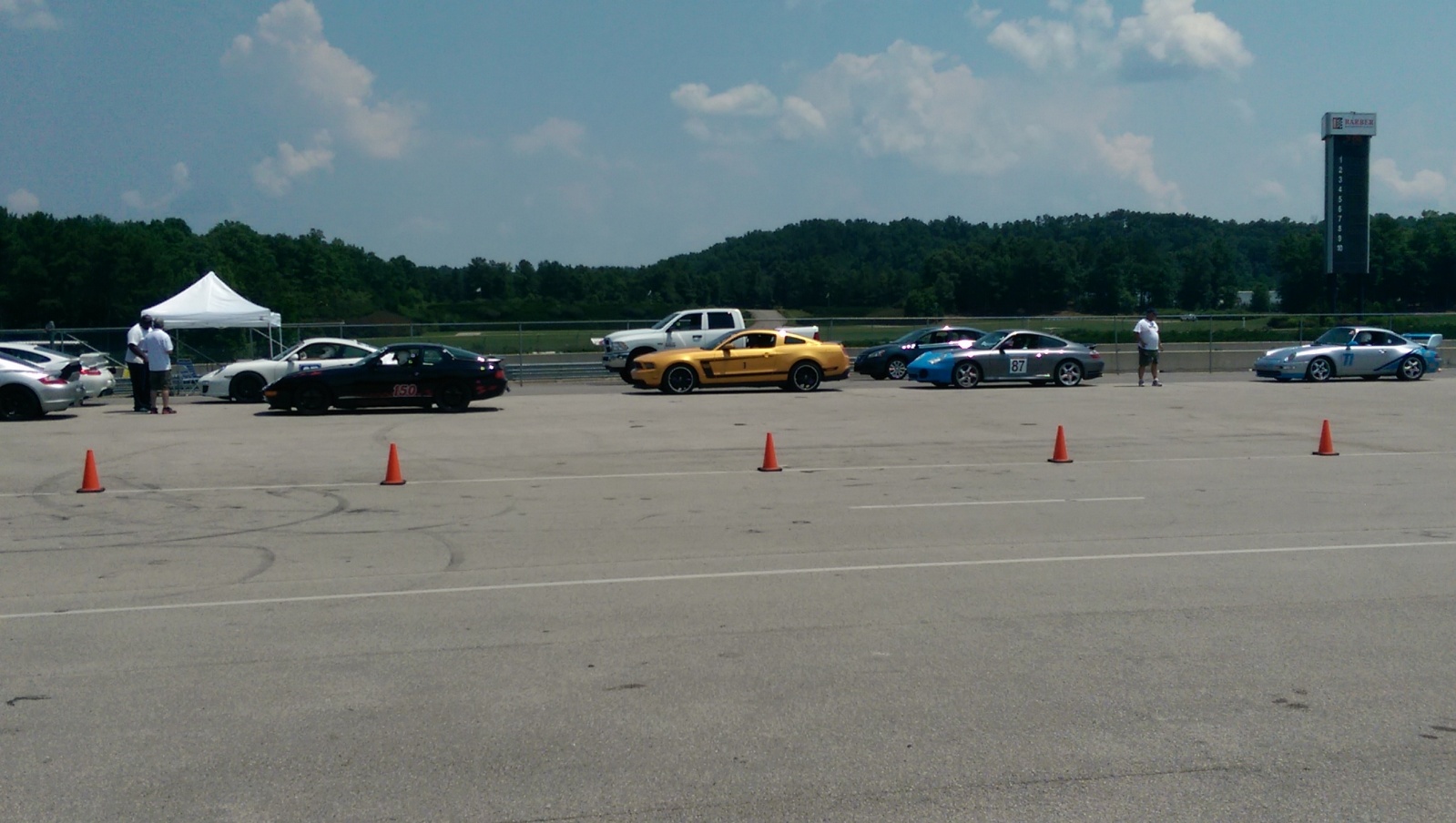

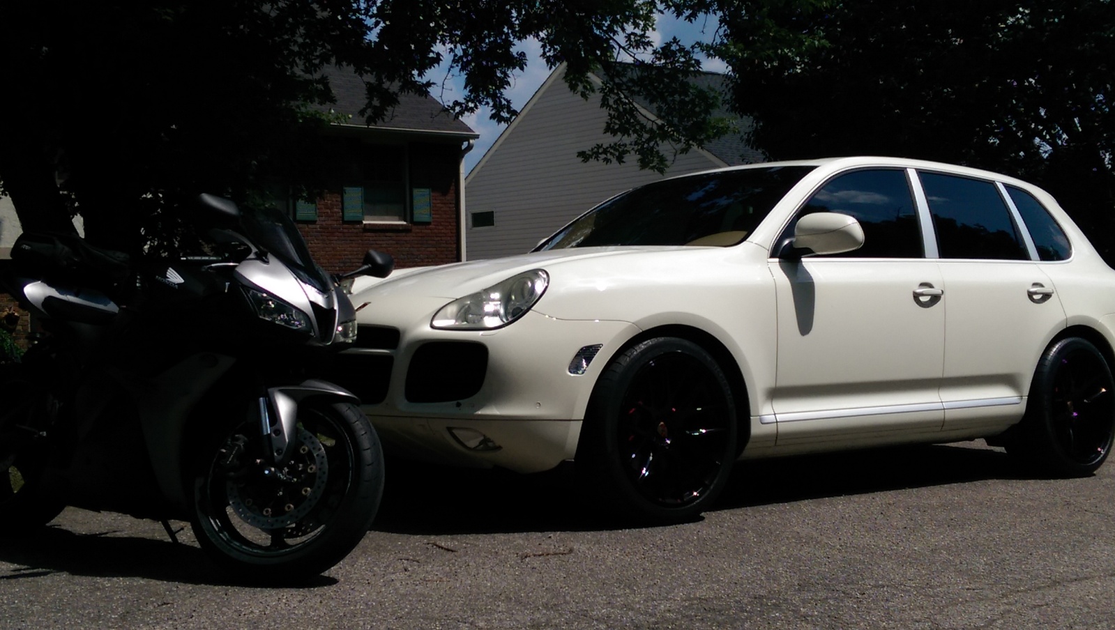

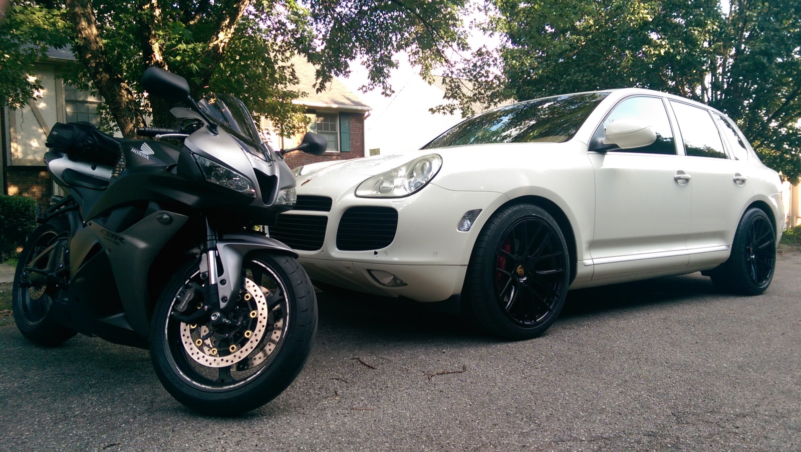

Went for a bike ride today and went by Barber Motorsports Park. The Porsche Club of America had rented it out so I got a guest pass and went down to the paddock area to hang out for a bit. Lots of very nice cars out there, wish I had known about it, might have considered taking the pig. Pics are on the way...
My phone takes awful photos but here goes:

Those wheels look great! Mind shooting me some info on where you got them? I really want to blac mine out, I think it will look wicked. Also did you lower it already with the durametric? It looks really low!

Thank you! I got them from wheel dynamics, 808 style on ebay. I tried lowering with the durametric but it kept saying it failed, but I think it did lower it. I haven't been able to go back and check yet as I haven't gotten it on a completely level surface (BMW lives in garage).

Wheels
Car looks great from what it looked like from the start. What is the size on the wheels and tires? What was the setting you use lowering the car? Any roughness on the ride? Would keep the Porsche. Thanks

Thanks! The wheels are 21x10.5, tires 295/35/21. I went down (up) 25mm on the durametric but it said it didn't register so I reset to stock values. Still it seems a little lower to me than normal. I drive around in regular/medium ride height with shocks on comfort and the ride is only minimally effected.
