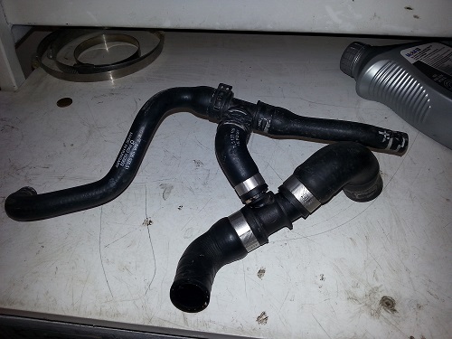

Okay, so lets say I go through the whole process of taking off the intake manifold like I was going after the plastic coolant pipes on the top of the engine. Anyone have pictures of what the T pipes look like and where both the top and bottom ones are located with a diagram?
This is a picture from the rennlist link provided above:
Old Jun 6, 2014 | 06:58 AM
mtnrat's Avatar
Joined: Aug 2012
Posts: 359
From: Cdn Rockies
Rep Power: 80
mtnrat Is a GOD !mtnrat Is a GOD !mtnrat Is a GOD !mtnrat Is a GOD !mtnrat Is a GOD !mtnrat Is a GOD !mtnrat Is a GOD !mtnrat Is a GOD !mtnrat Is a GOD !mtnrat Is a GOD !mtnrat Is a GOD !
I don't have a diagram. I drove the car up on some blocks for extra height, and raised it as high as possible. Took off the manifold and looked and felt around from top and underneath to figure out how it was all put together.
