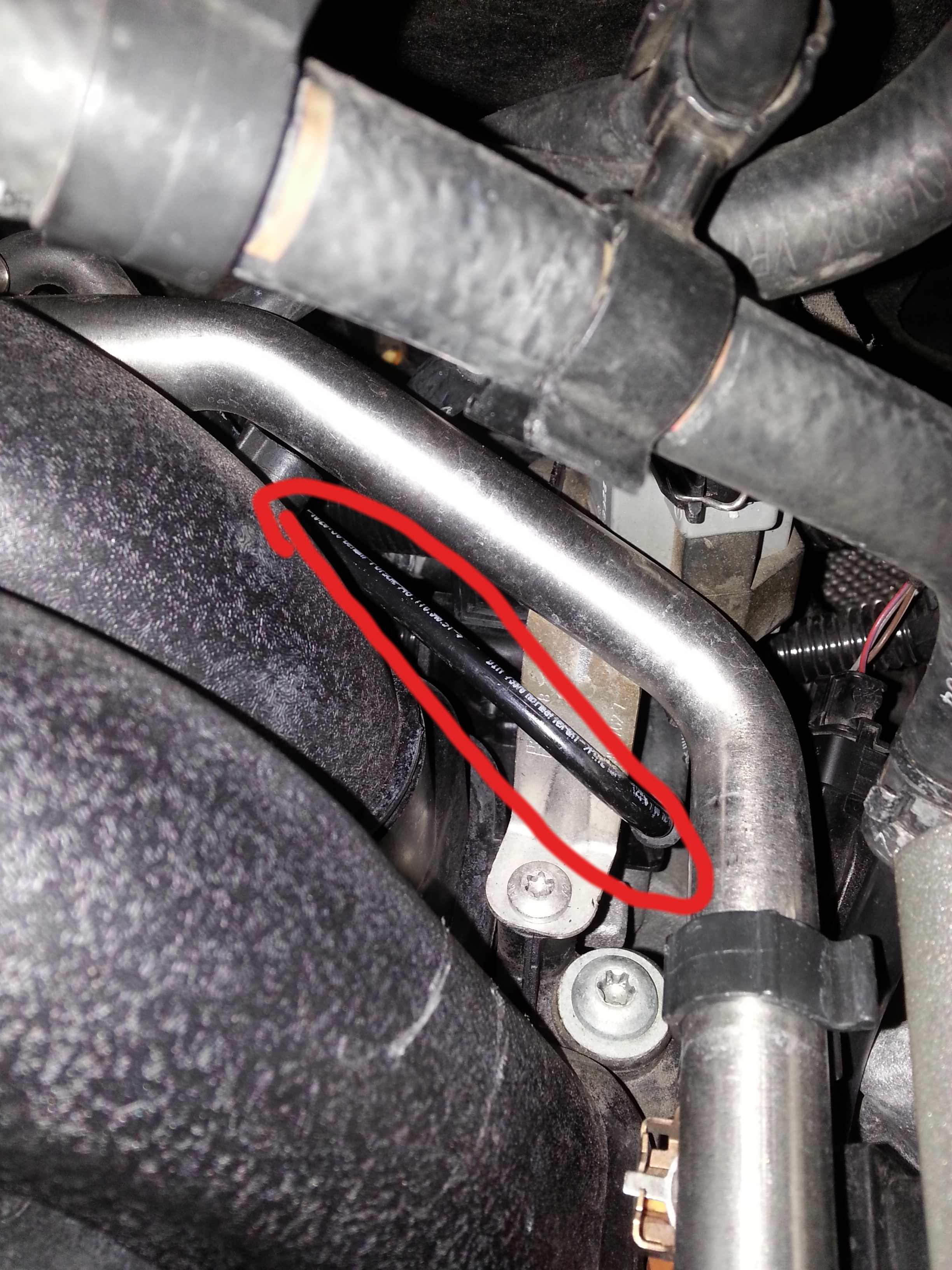

Washed, dryed and parked in the garage last night. Called it a night. Today I've got the engine dressing off and have verified it's got an EVONS intake kit which is the dual filters, heat shields and silicone reducers which feed into the stock piping. I'm only seeing .6 bar on the stock boost gauge, but I'm still going hoping it's got software...and if not, that means it's only going to be faster. I pulled all the fuses on the drivers side under the hood, but the amplifier is still giving me the same error message.
I'm trying to see the coolant pipes per this write-up - rennlist.com/forums/porsche-cayenne-forum/550109-plastic-or-aluminum-coolant-pipes-how-to-tell-without-intake-removal.html but I just can't see with either my inspection mirror or my endoscope. For now I'm just going to assume it's been done since there is a vacuum hose routed differently on the vehicle (circled in red) vs how it's done in the write-up. Time to raise the truck for engine leaks, then hopefully I'll find some aftermarket diverter valves, a healthy cardan shaft, second cat delete pipes and.figure out the brand of this muffler.

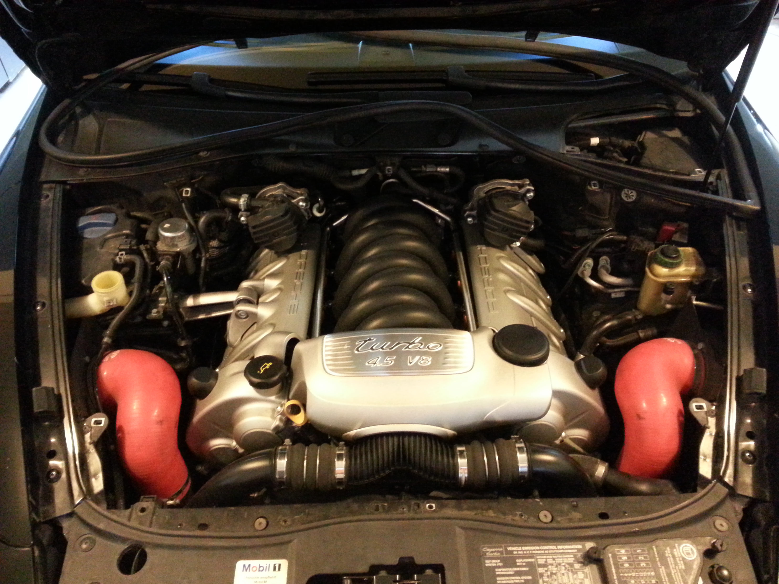

Upon further inspection, this thing is actually in pretty good shape. Cardan shaft looks fine, center support bearing and guibo donut are fine. I removed the task lights, and other than a little rippled bend on some metal by the hitch, it's completely fine. I'm starting to believe him on that he things it was an insurance scam since he found everything inside the trunk. He said he put everything back on, did some welding on the mufflers and replaced the tail lights and added wheels (found the receipt for $2k in the Goode box with the owners manual). I still haven't verified the coolant tubes.
What I've found though:
- Rear main seal is leaking
- Slight oil leak by drivers side intercooler
- Amplifier still won't turn on - 148, fuses pulled on drivers side engine bay, all to no avail...any other suggestions?
- Hatch shocks are getting weak
- Stock diverter valves - is .6 bar standard with these mods? Since boost is relative to its restrictions of flow, I know better exhaust will reduce back pressure, which could explain it.
Aftermarket mods:
- Milltek exhaust with 2nd cat delete pipes (2.5") feeding into a resonator-free exhaust (2.75") into their dual mufflers
- EVOMS CAI
- Still not certain about a tune. Other than calling each vendor with the VIN, is there any other ways to verify?
I took a handful of pics, so it was easier to upload here - s42.photobucket.com/user/m5james/library/2005%20Porsche%20Cayenne%20TT?sort=3&page=1
So, with all that said, what's the consensus on what I should offer based on what it needed?

The drivers side intercooler leak is very common.. I went to local Porsche dealer (Barrier in Bellevue) and they knew right away what seals I needed and it was just a few bucks. I haven't taken it apart and done it yet, but I don't think its a difficult fix from talking with one of the techs there.
Also I think .6 bar is stock boost, the Cayennes that I've been in with tunes have both pegged the boost gauge over and held it there. Mine is 100% stock and boost goes to .6-.7 and slowly tapers off as rpms rise. Sometimes if Im building boost at part throttle and then punch it I can spike it a little higher, but it quickly settles to normal.
Being an insurance scam or not doesn't change that it is still a salvage title.. I wouldn't want to go very high on it. The amp issue could be something bigger, so I would want to negotiate even further in case a lot more needs to be replaced. I would want to get it around 12k-13k.

He said he's only seen .8 if he did it from a dead stop, then each gear afterwards it tapers down. That sounds like old school homemade boost controller type of dropoff vs an electronic controller like when I finally stepped up to a Greddy Pro-Fec in my MR2T and RX7TT days. I've read upsolute makes the most boost, but if he's holding stock levels, I'm going to guess it's on stock software.
He said the amp had quit only a day before I came to test drive it. When I took it back to him yesterday and told him what I'd tried, he knew about the 148 code and informed me he replaced the amp once already when he got it from auction, so I'm guessing there's something else at play here. While the stock system is nice, I think aftermarket is gong to be my easiest solution, be it replacing the amp and/or the deck.
