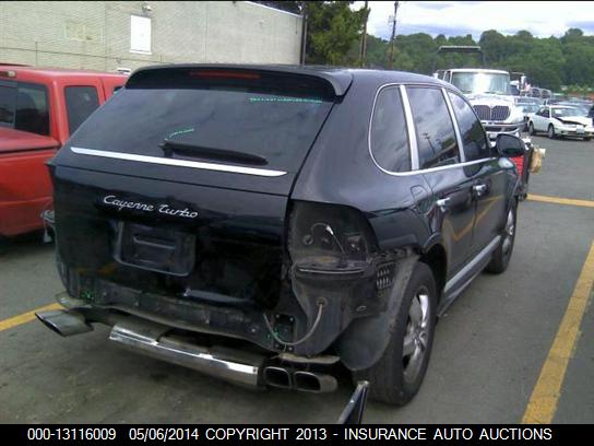

Now, as for the Cayenne's I'm looking at. I'm still on the fence, each has it's pros and cons, and I'm still researching (just read a thread where I should be getting these both for a few thousand less) but I figured I'd get the intro outta the way and do my own thread searching before I go asking questions that have already been asked.
2005 w/ 106k - seattle.craigslist.org/see/cto/4592428205.html
seattle.craigslist.org/see/cto/4592428205.html[/COLOR]
Pros:
- Aftermarket intake (have yet to determine the brand, I just saw red silicone hosing under the engine dressing)
- Aftermarket exhaust (looks similar to the Cargraphic system after watching some of Fabspeeds comparison videos, but the dressing shield between the mufflers looks different) I've yet to see if it has the 2nd cats deleted or the rest of the exhaust system
- I'm going to call software companies to see if they can tell me if it has their software based on the VIN. It does great at holding gears during deceleration, so that's what's making me wonder if this is normal or something that happens after getting tuned. It admittedly feels slightly laggy (I'm spoiled by the INSTANT torque of my SC'd truck), but once it comes on, it's hard not to let off the throttle
- 106k miles
- Parking sensors
- 20" wheels
- Aftermarket LED taillights
- Aux headphone jack and iPod connections in the glovebox
From how it feels compared to my X5, plenty of power. I wish the turbo's and BOV we're more audible, but that's something I look into later if I get it.
Cons:
- Salvage title from a rear end hit. I don't mind the salvage so long as it was repaired and still functions structurally in the case of a rear impact while I'm owning it. The owner showed me pics of when he bought it at the auctions, and it didn't seem that bad. Bumper was knocked off, the mufflers were broken where they're welded together (he redid the welds, it doesn't leak). There is still a bend in the plastic bumper on the RH side by the tailgate, then there is a crease on the RH bottom corner of the tailgate itself.
- Tailgate won't open via the button, it has to be done w/ the key
- No sunroof
- He claims that only recently it gave him the amplifier failed warning so I couldn't listen to the stereo
- No service records since it's an auction car. He's done an oil change and changed the drivers side front 02 to get rid of a CEL
- Slight vibration at highway + speeds
- Decent clunk when I put it into reverse on his sloped driveway with the nose pointing upwards
- Drivers side red button for the belt buckle release is broken. It still functions, but the plastic portion is cracked

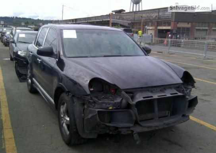

2004 w/ 120k - http://seattle.craigslist.org/est/cto/4632721127.html
Pros:
- 22" wheels
- Front brakes redone recently, I'm not sure about the rear
- Body is clean minus a small dimple on the hood and a couple marks on the bumper around the hitch
- Sunroof
- History for the past 2 or so years from them owning it and servicing it at either a Porsche indy or a friend who worked at a local shop.
- I doubt I'd use them, but has the roof rack crossbars
- Bose system (not sure if that's standard and I didn't pay attention to it on the previous listing since the stereo wouldn't turn on)
Cons:
- Hood shock needs replacement
- Needs valve cover gaskets (started smoking from the drivers side after a short 5-10 min around the neighborhood he lives in. I was never able to get over 30MPH (I was coming back from a vacation when I happen to be in the area and looked at it, kids in the car) so I don't know how the wheels/suspension will do on the highway
- Door speakers rattle (might need to be retightened throughout)
- No parking sensors (EDIT - apparently it does, they've been disconnected by the previous owner)
- At slow speeds of around 5MPH, I could let on and off the gas slightly and hear a clunking sound. I'm wondering if this is a driveline support bearing/guibo donut issue
That's all I've got off the top of my head. I'd like some opinions if you've got them, links of threads if something sounds immediately familiar, otherwise I'll continue reading up like I have been the past few weeks. Yesterday is the first time I've driven one of these, so the only issues I knew of really was coolant pipes and transmission valve bodies, so now I've got some new things to look into before I decide.

Ive seen the second one around Redmond and Bellevue a few times recently. Its been for sale for a long time, Ive seen its ad on craigslist since at least May.
Hopefully everything checks out on the 1st one, good luck!

Yeah, and I think he's starting to get the idea that he's asking too much since he's offered to drop $1k off the price after I mentioned the things I found in the short 10 min I drove it. He's already bought the Suburban, so now it's just taking space.
The first one I've done some research into the insurance auctions and they tend to average $3k-$6k, he's rewelded the exhaust together where it snapped at the middle supports, then simply re-attached the bumper and threw some wheels on it. Pending my inspection this weekend, the first one is still the better deal to me considering it's newer, 15k lower miles, some decently priced performance mods (they were on it when he bought it, so he can't justify charging mange extra for them) and the engine compartment seems to be better shape. The rear end pic is one the owner sent me and has only claimed the rear damage, but a Google search of the VIN found me the picture of the front directly from the auction site. I haven't told him I've found that picture, so we'll see how he dances when I bring it and any issues up after I give it a buyer's inspection.

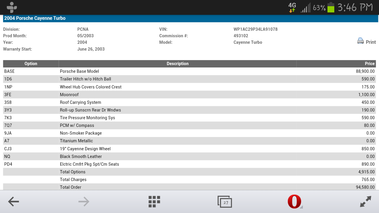

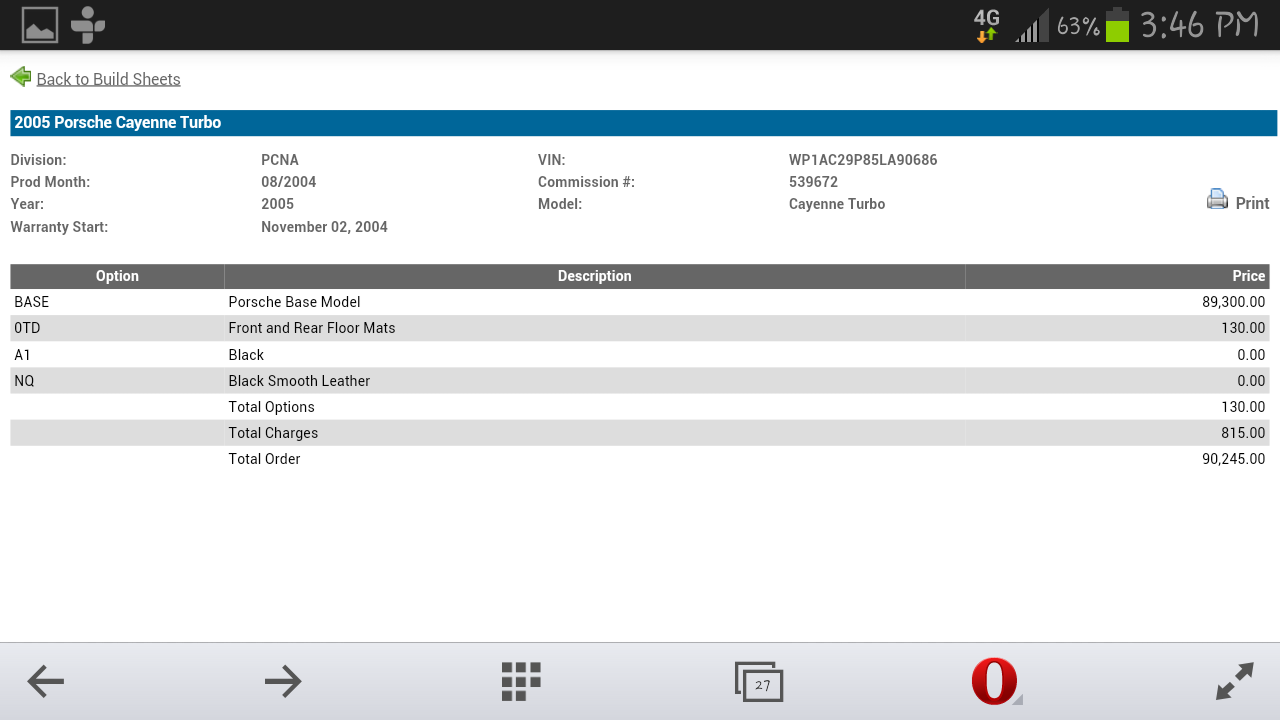

Running a VIN search on both, the first one has no options, the second has more, but after reading these forums and past for sale/sold threads, both these guys are roughly $2k over-priced IMHO even though both have aftermarket wheels that they're trying to recoup the cost of.

Reading over the factory options of each one, is there a website/thread showing the difference between a base 04 vs base 05 seeing there's a minor $400 difference. I remember them both having parking sensors, roof rack tracks and other similar things, yet the '05 looks stripped based on that website.
