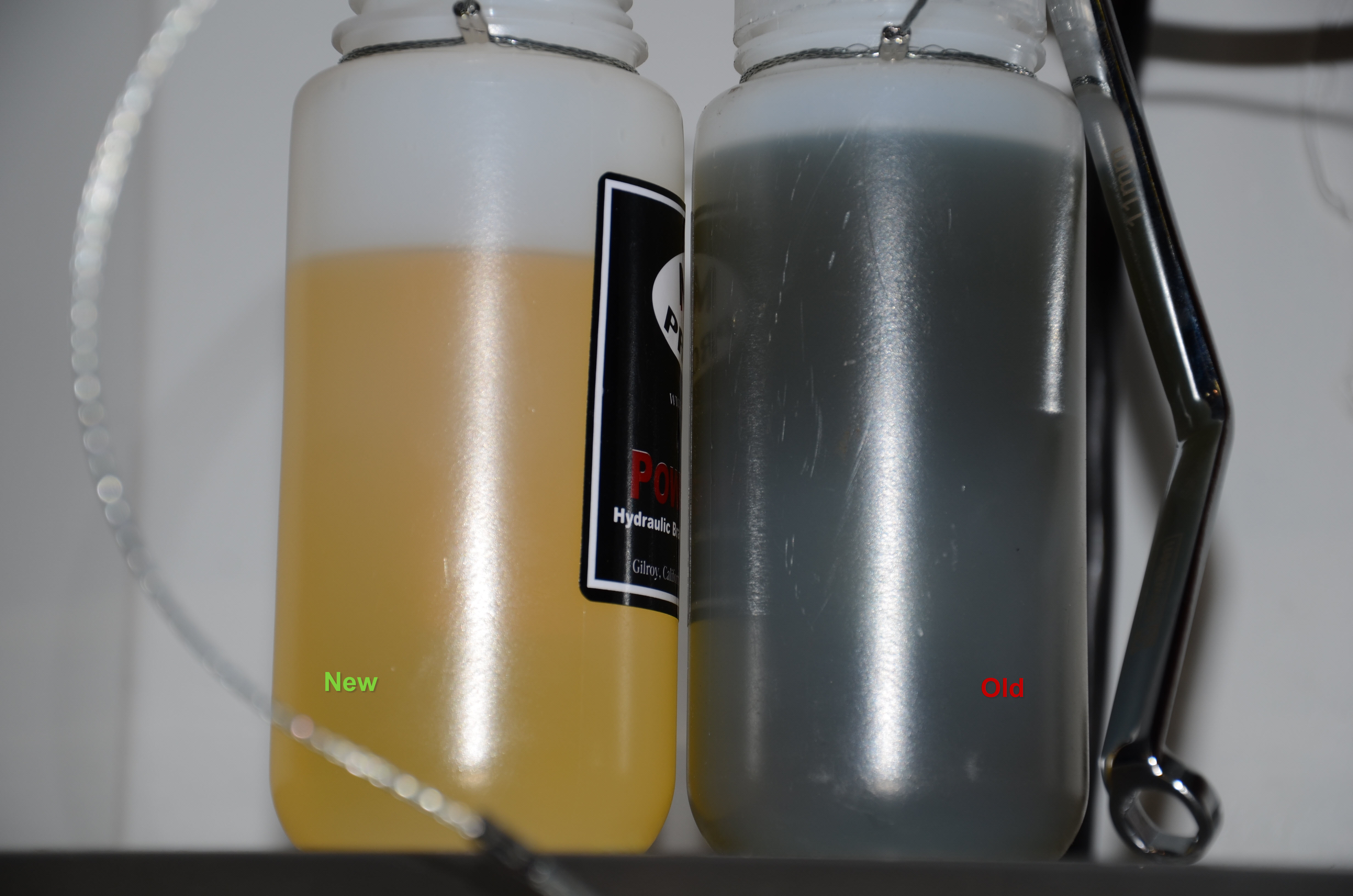

Okay, I finished the following today,
Oil change / filter
Air filters
Spark plugs
Serpentine belt change
Brake fluid change / (Had lots of air and was very dark.)
LED interior change
Wiper change Front / Rear
Need wiper fluid / Thinking new battery.
How does one know when the battery is about to fail?
