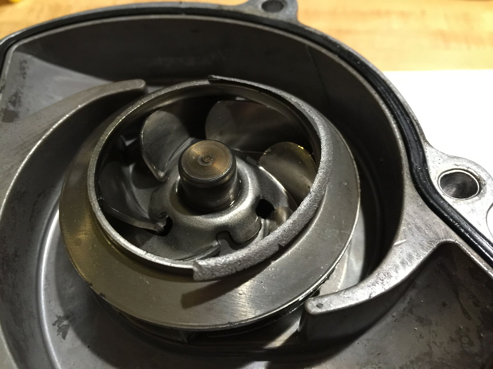

I tried using zip tie method to pull out but did not work. Was stuck in there pretty good! I did fun a large metal shaving I can't figure out why it was in there or what it is from?

The metal shaving you found, maybe from water pump?

Looking at the shaving I found maybe it is from the pump? Not sure how that's possible pump feels solid with no play.

That is very strange. Casting left over? its a huge piece.

I think I found where that piece came from.
