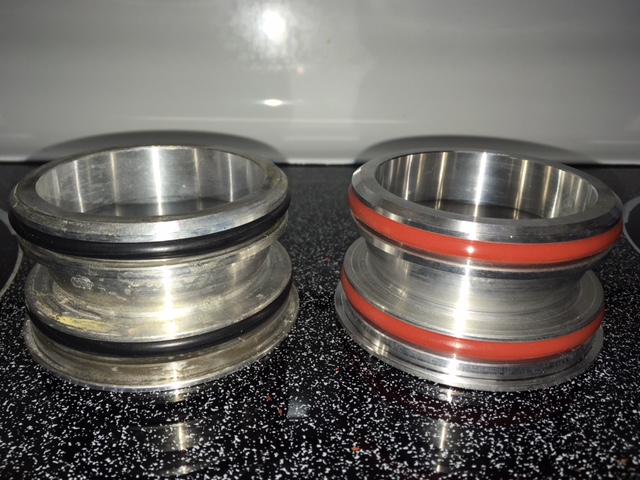

Hello, thank you for the reply.
Back story. I replaced my plastic intake socket in Jan of 2016 with an aluminum one from ECS Tuning. I had no leaks with the plastic intake socket at the time and this was only done as a preventative measure. The thermostat housing gaskets on its underside were not replaced at this time.
Anyway, I smelled coolant from that day forward and after towing my boat 500 miles to my next duty station in July of 2017, the smell was extremely bad.... I opened her up to take a look and there was coolant that had gelled/ crystalized in the 'V' roughly 1/4in deep. I cleaned it all out as the first step, and replaced the under side gaskets on the thermostat housing as I knew everything else was relatively new. I also replaced my water pump because the shaft had some play in it.
Upon replacing the water pump, I figured I would inspect the thermostat and intake socket. I relubed it, and stuck it back in, installed the pump, closed everything back up, refilled the coolant and went for a drive. Upon parking the car at my house, coolant was pouring out!
I filled the system from the reservoir, and just as fast as I poured it in, it was coming out. I opened everything back up and was as able to determine that the leak was coming from the old aluminum intake socket as I could see a constant yet subtle disturbance (about a drop every 3 seconds) of the coolant that was sitting under the thermostat housing in the forward most pocket of the 'V' after pouring a cup of coolant in the reservoir. It leaked from the housing to the rear of the 'V' where it then went down the drain and out the bottom of the bell housing.
This past weekend, I reordered a new aluminum intake socket from ESC Tuning. Upon receiving the new intake socket, I immediately noticed the difference between the old and the new. The new one has red gaskets and the old had black. The material is different as well. New gaskets are slightly less dense yet with the elasticity to hold its shape when compressed. The old gaskets have a visible impression along the edge of both rings where it mated with the thermostat housing (it is not the line that is left from the molding process of making the gasket), and this leads me to believe the gaskets were crap to begin with ; not to mention, the intake socket pulled out with little to no force at a all, as opposed to removing the original plastic intake socket, which was a significant emotional event.
I purchased a new thermostat and I am awaiting for it to arrive as well so I will be slapping all new parts in there with the exception of a new thermostat housing itself. If it leaks again, that will be the next part to be replaced though the housing had no pitting or damage where it mates with the intake socket gaskets.
The rest of my parts will be here on Monday so I will provide an update when I put everything back together.

So for me, it was in fact that thermostat socket gasket. I’ve been running the car hard since the swap out in Oct, and not the least bit of stitch of coolant. Before I closed everything back up, I washed the ‘v’ and let the warm soapy water travel the same route the coolant took when it was leaking.
