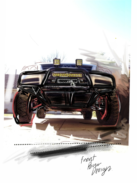

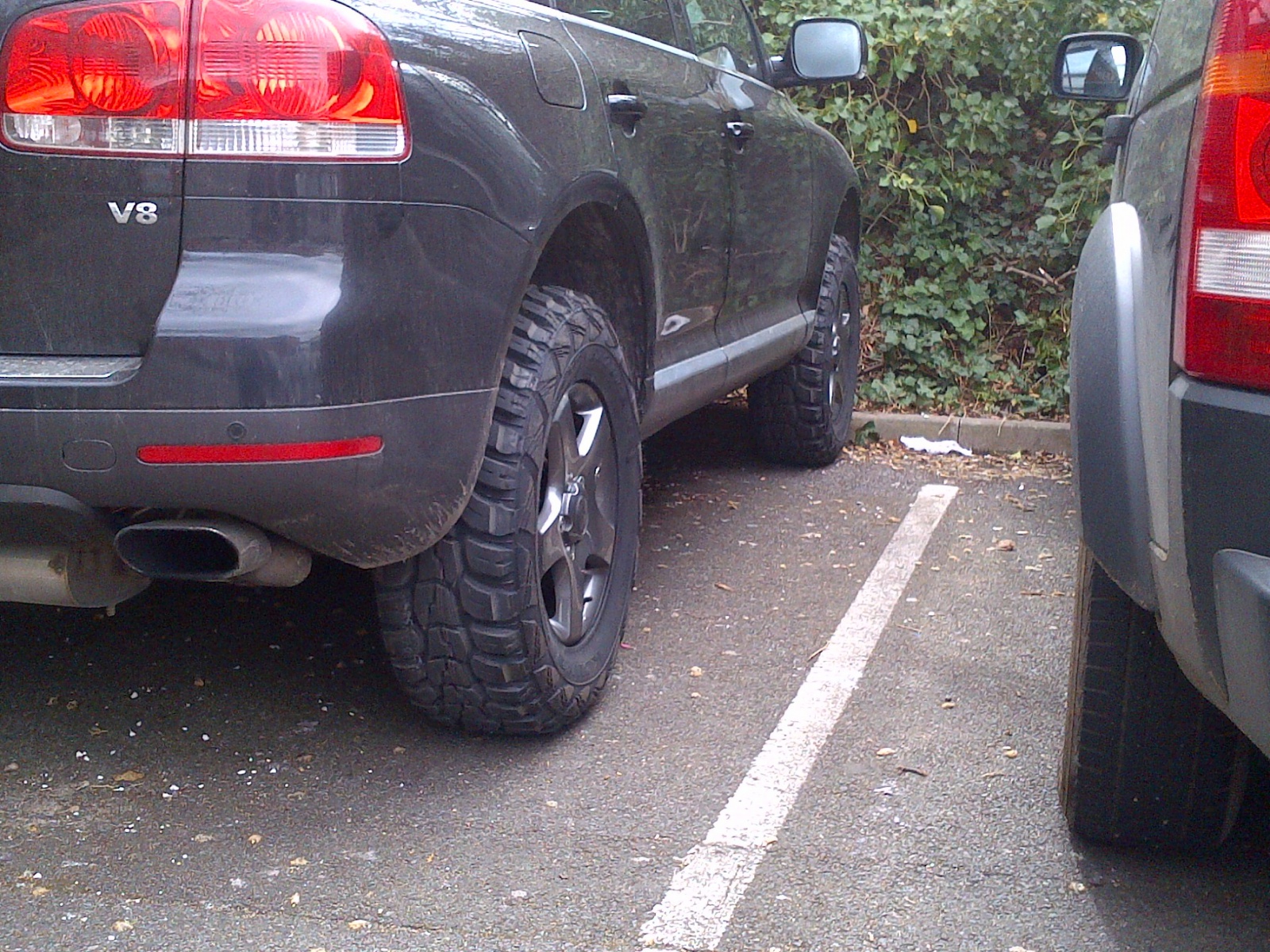

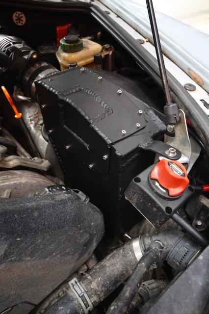

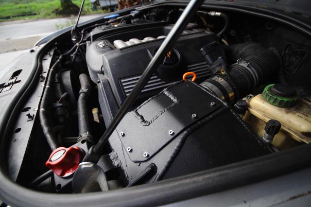

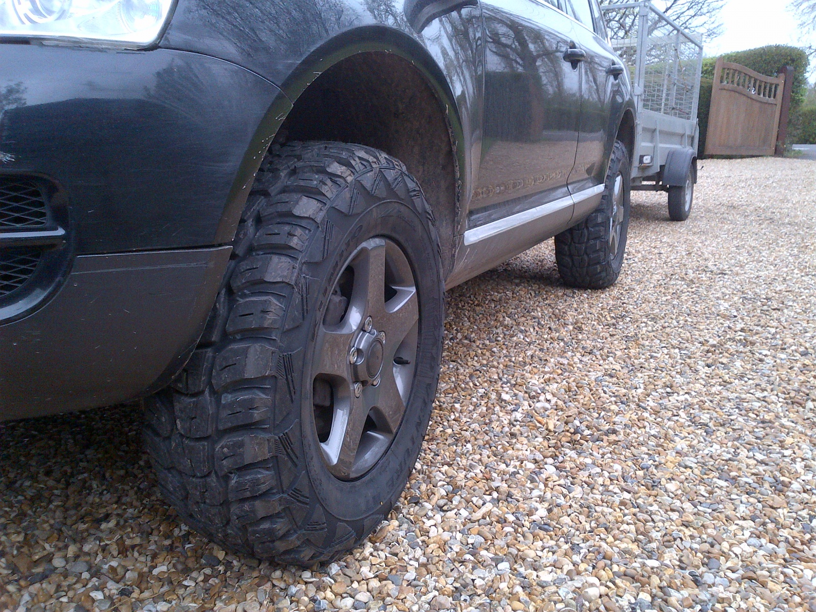

Here are pictures from some of his builds and others he sold lifts too
