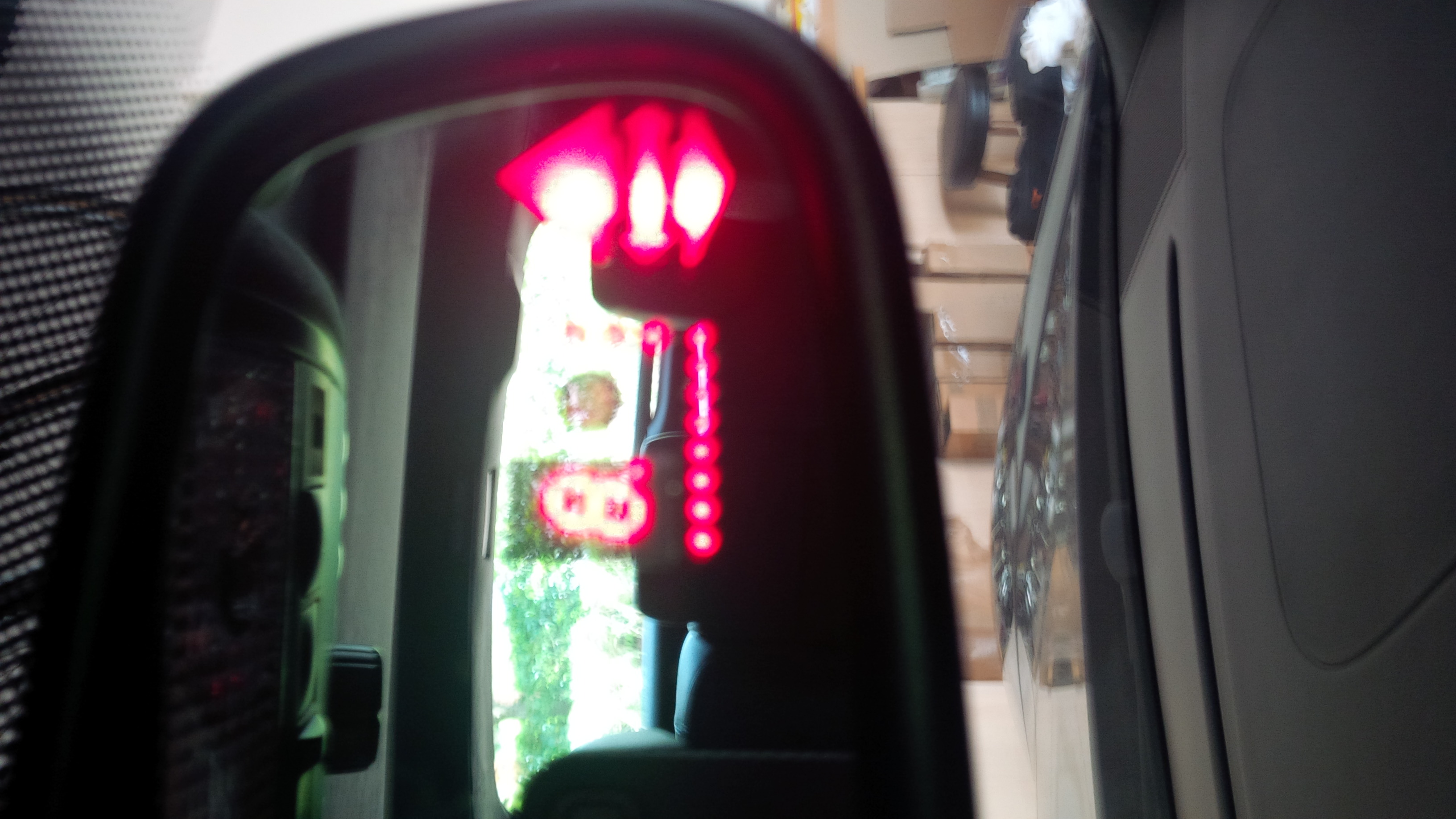

Yes the GTS is a great vehicle, and I particularly like the color of this one which is Marine Blue Metallic (no longer available ) Here are a few shots of the controls and mirror. I would have taken pics of the inside of the bottom cover but since I've had it on and off 3 times I don't won't to tempt fate and snap off one of the two tabs on the upper cover. But looks like they simply cut a rectangle thru the sheet metal in the bottom cover, took the plastic cover off of the V1 remote audio box, drilled precise holes thru the steering wheel cover, and hot glued the V1 board directly to the bottom cover. [The infamous rocker switch is actually the one closest to the driver. ] The RJ-11 wires are feeding up the driver's A pillar and then across the headliner edge to the mirror, and as I said earlier I'll bet the base unit is up there somewhere. BTW, the auto dim on the mirror still works fine as well. All in all a pretty neat job. (You'll notice they even drilled a hole for the headphone jack)

Hmm, looks like a pretty slick install!! Nice save fixing it!!
