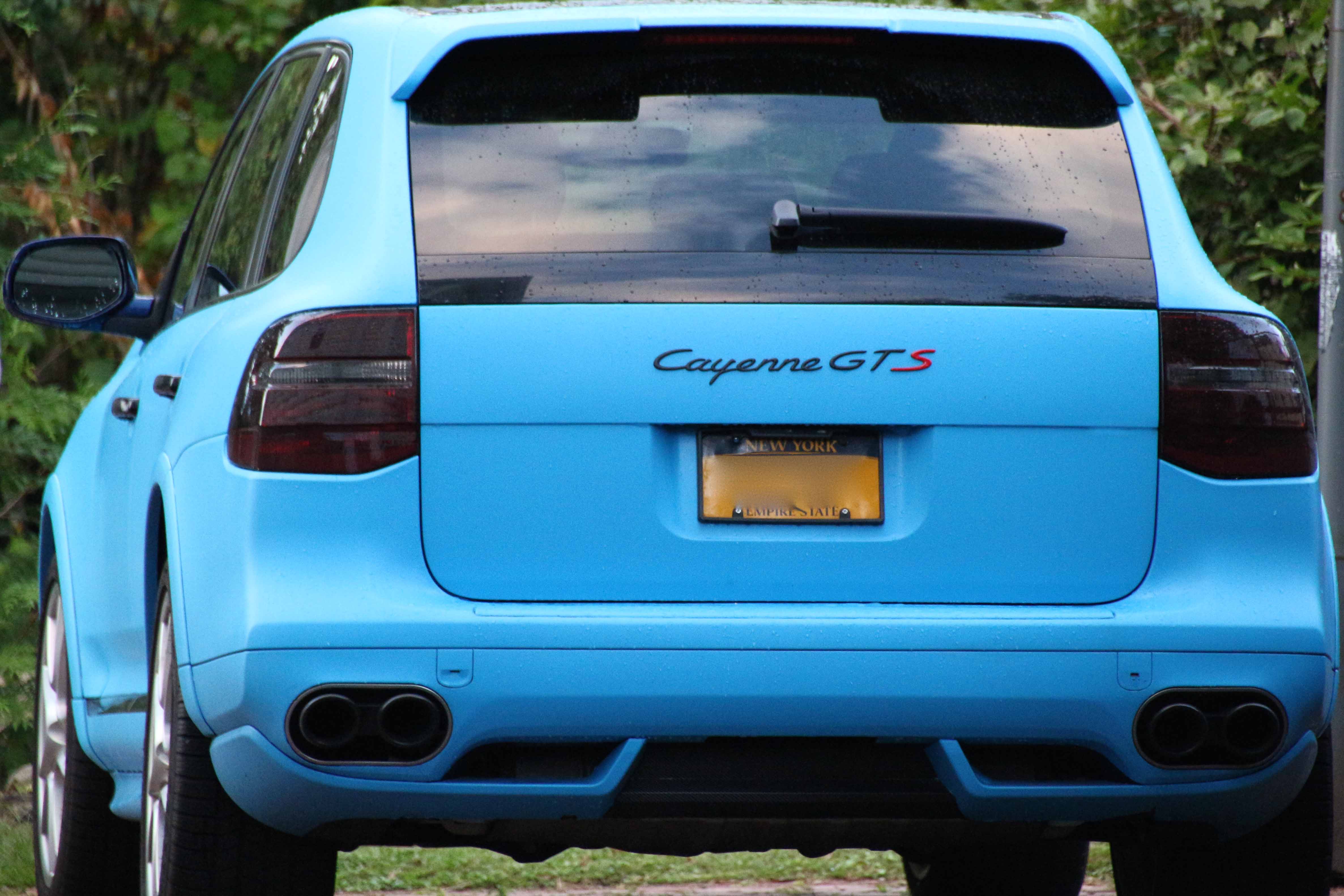

Does anyone have instructions on how to remove the GTS rear Spoiler (where the 3rd brake light is). I just wrapped the car but i want to remove spoiler so i can replace it with a new carbon fiber one. Any help is greatly appreciated.

First of all, love the look. I really thing the 957 GTS is one of the best looking iterations of the Cayenne. Just has a bit more aggressive look.
As for the spoiler I believe the fasteners are accessible by opening the rear deck lid or the glass section. There shouldn't be many fasteners. then it should come loose. Not sure on the 957 but on the 955 there are electrical components in there somewhere (like satellite radio antenna) though so not sure how easy it is to swap over.

THere is three torx screws under the spoiler inside of rear hatch, covered by plastic caps. Open hatch and you will see them.
