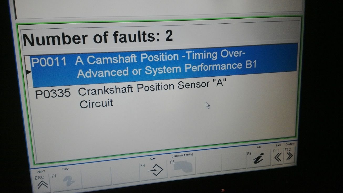

As I am bring in the truck after work today I do have a few questions on what to ask. (Forgive me for my ignorance) I should tell him to check the Crankshaft position sensor, or the camshaft one? I think this will be his second to last chance fixing the pig. If he can't fix it I'm going to suck it up and go to Porsche.

Actually, it would be better if you did have the CEL on, as you would have specific codes available in order to track down the fault.

It will be very difficult to "check" the crank sensor as your problem seems intermittent.
The fault codes will have to be read out.
I had fault codes for the crank and camshaft sensors,
I replaced the crank sensor, and both codes went away.
FYI, you can have fault codes on the DME even without CEL or other warnings on the dash.
Process of elimination is going to leave you frustrated and possibly cost you more.

Went to local independant shop for lunch
I had both of those codes too as well as 6 others and my CEL was not on either. I had a fuel pump code in there as well. He saved my codes and then cleared them. The car acted up but only the crank fault came back. So I let them order one to install tomorrow in the am. It is a real fault as well as the cheapest thing to install. I will keep you posted...
